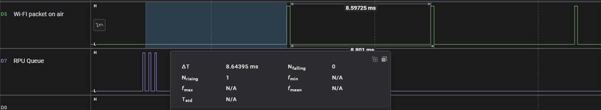

Dear Team,
I have a question regarding the Wi-Fi radio TX test mode on the nRF7002-DK. I want to send Wi-Fi test packets of different sizes consecutively, which works fine. The problem is the delay between two packets sent consecutively. In NCS v2.4.2 it takes ~8.6 ms between two sent packets (see figure below); in NCS v2.3.0 it took "only" ~5.3 ms.
About the figure: The green line shows when (and for how long) a Wi-Fi packet is transmitted (measured on another device). The purple line shows when the Wi-Fi send command is placed in the RPU queue. So, you can clearly see that 3 commands were queued and after 8.6 ms the first packet was transmitted (and after another 8.6 ms the second and so on).
To my question: is there any way to reduce this delay? If so, to what extent is it possible?
I used the following configurations:
