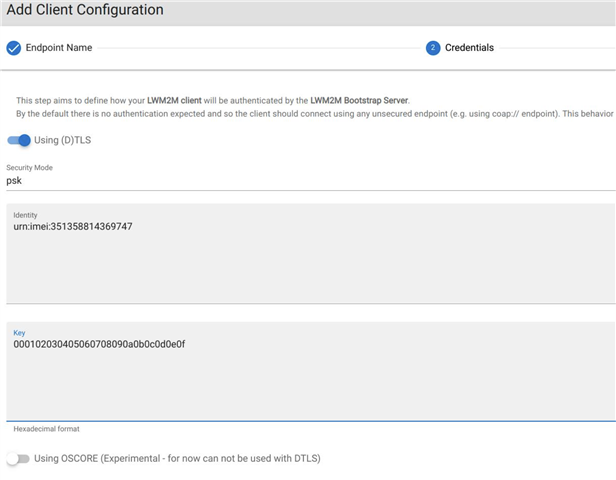

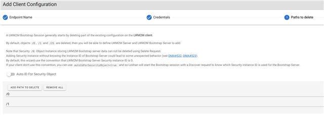

After changing the .conf file to support bootstrap, I can't get it to bootstrap in either Leshan or Coiote...
I just added the contents of overlay-xxxxx-bootstrap.conf (line 92-96)

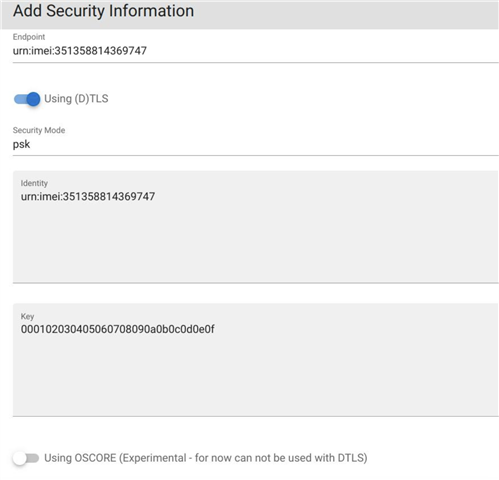

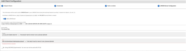

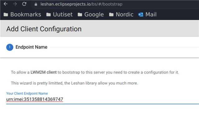

  • Sorry for the late reply. Have been waiting for an answer from our experts.
    The bootstrap process might fail as it will not overwrite the credentials in the modem. You will need to ensure that you have removed the credentials from the sec_tags, as described under Provisioning the identity and security credentials. You can use the AT client sample to ensure that they have been removed with the %CMNG AT command, for example:
    AT%CMNG=3,35724861,3
    AT%CMNG=3,35724861,4
    AT%CMNG=3,35724862,3
    AT%CMNG=3,35724862,4
    If you have done this correctly, the bootstrap process should work.
    You must also ensure that you have written the security information to both Leshan bootstrap server and the Leshan server.
    Leshan security entry:
    Leshan bootstrap entries:
    The images might not be in the correct order. Please review and let me know if anything is unclear.
    As   points out, a modem trace will be best in order to see what fails in the process.
