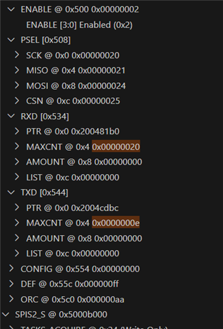

SPIS spi_transceive returns but no data in rx/tx buffers
NCS v2.3.0
nrf5340dk_nrf5340_cpuapp_ns
Devicetree is configured so SPI2 is a SPIS.
My calls to spi_transceive are waiting for the SPI operation but when the spi operation is complete spi_transceive returns but rx and tx data sent is 0.
I have a SPIS POC which is working but it is not in a TFM environment.   In the POC (non-TFM) environment I confirm the SPIS2 secure peripheral settings are identical to the settings configured into the non-secure peripheral.  The only difference is the "amount" register for secure peripheral reports 0 data received.
Any suggestions why no data would be received?
