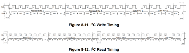

Does Zephyr I2C APIs support 16bit register address on ncs v2.4.2?
From https://docs.zephyrproject.org/latest/hardware/peripherals/i2c.html link, I didn't find any APIs for 16bit register address. Does Zephyr I2C APIs support 16bit register address on ncs v2.4.2?

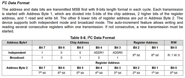

  • The I2C standard does not support 16-bit device addresses, and the datasheet you referred to shows a 7-bit address (+1 write bit). The second address byte is for the internal register address in the I2C slave and, from the I2C protocol's perspective, it's treated just like any other data byte.

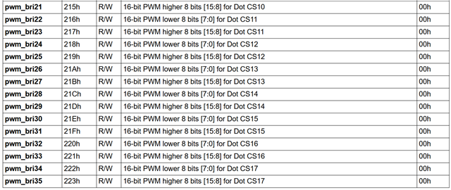

  • Thanks for your reply! I can read/write registers now.
    static int _lp5861ReadReg(uint16_t regAddr, uint8_t *regVal) {
        printk("tca6424aReadReg(regAddr=0x%x)\n", regAddr);
        const uint16_t devAddr   = LP5861_CHIP_ADDRESS | _lp5861GetRegAddrHigh(regAddr);
        const uint8_t  startAddr = _lp5861GetRegAddrLow(regAddr);
        printk("devAddr=0x%x, startAddr=0x%x\n", devAddr, startAddr);
        uint8_t rbuf[2];
        const int ret = i2c_burst_read(_gI2cDev, devAddr, startAddr, rbuf, sizeof(rbuf));
        if (ret < 0) {
            printk("i2c_burst_read(0x%x) failed, ret=%d\n", regAddr, ret);
            return ERROR_I2C_READ_FAIL;
        printk("rbuf[0]=0x%x, rbuf[1]=0x%x\n", rbuf[0], rbuf[1]);
        *regVal = rbuf[0];
        return 0;
    static int _lp5861WriteReg(uint16_t regAddr, uint8_t regVal) {
        printk("tca6424aWriteReg(regAddr=0x%x, regVal0x%x)\n", regAddr, regVal);
        printk("_lp5861GetRegAddrHigh(regAddr)=0x%x\n", _lp5861GetRegAddrHigh(regAddr));
        const uint8_t wbuf[2] = { regVal,  0x00};
        const int ret =  i2c_burst_write(_gI2cDev, devAddr, startAddr, wbuf, sizeof(wbuf));
        if (ret < 0) {
            printk("i2c_burst_write(0x%x) failed, ret=%d\n", regAddr, ret);
            return ERROR_I2C_WRITE_FAIL;
        return 0;
