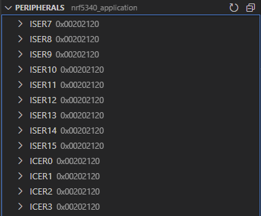

The Nordic plugin also does not help very much. I tried to check the NVIC peripheral, but Visual Studio Code just shows some garbage values that don't make any sense for the register content (all ISER/ICER registers have the same value):

    And concerning the NVIC screenshot during debug, do you know what's the issue with it? Is this a nRF Connect SDK bug?

    For the debugger issue, I was able to reproduce this here. For some reason the VSCode debugger doesn't properly interpret the ISER and ICER registers as an array, and they all point to the same register (ISER0).
    If you try to read the register in the code, or debug with Ozone, the register values are correct.
    I will report this to the VSCode team and ask if they can look into it.
