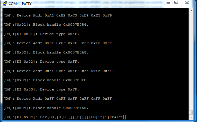

  2. The log information coming from the device manager in dm_init gets garbled after several lines but before the routine finishes. When I have log support in everything enabled, the garbling prevents me from seeing my own application messages created during startup. It also appears that old log information from a previous run is still being spit out at the beginning followed by the startup debug information that I would expect, and last the garbled ending prior to dm_init completing. See attachment 2 attachment2.PNG

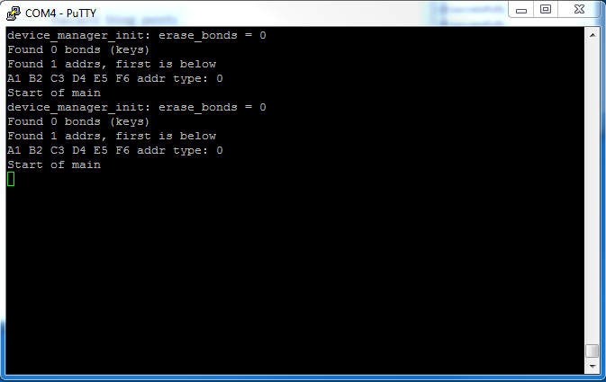

  3. When I write my rscs image to flash using nRFgo Studio, it appears that it restarts the firmware twice. Maybe this is normal? I don't see how the code could be resetting itself. If this is true, it would also cause a lot of text that would possibly be contributing to the 2nd problem. See attachment 3 attachment3.PNG
EDIT: I should mention that I've upped the UART tx_buffer size from 256 to 1024 and increased the baud rate from 38400 to 115200 to see what difference that might make. Also, I realize now #1 should be a separate question.
EDIT2: The third observation is as expected - it is because of nRFGo. Using the reset button on the board (yes, why hadn't I tried that already :-) doesn't exhibit this behavior. So ignore #3.
EDIT3: I've solved the garbling problem. It turns out I was calling APP_UART_FIFO_INIT twice, once in main and also by calling app_trace_init(). This means that when I thought I was increasing the tx_buffer size, I really was not because the local define UART_TX_BUF_SIZE was not used - only the one in app_trace.c was.
