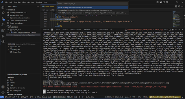

I can't get "nrf_dm" to build cleanly. I don't see anything in the readme that indicates I have to do anything special/additional... nrf5340dk might work  (I have to order 2x nrf5340dk's), but it generates enough Warnings to be concerning... Eventually I will need to program SoC nrf5340 on a custom PCB and that doesn't compile at all.
  1. Board: nrf5340dk generations a number of warnings.
  2. Board/SoC: thingy53_nrf5340_cpuapp fails spectacularly...
Also, which may be related, I can't seem to be able to select a "kit" and have "No Kit Selected" in the bottom toolbar. I "repaired" the "nrf-command-line-tools-10.23.0-x64" installation, but no improvement. None of the Kit options: Scan, Let Cmake guess, gcc... improve my results.
I assume my problem is in my VSCode setup? I am a new user, w/new nrf_connect install. I have spent weeks trying to get the nrf connect environment working in VSCode with little, but some, success.
I attached my nrf_dm files, support info, etc...

Thingy53_nrf5340_cpuapp (PRISTINE BUILD) WARNINGS:
"resource": "/c:/ncs/v2.4.2/zephyr/include/zephyr/device.h",
"owner": "cpptools",
"severity": 8,
"message": "'__device_dts_ord_DT_N_NODELABEL_ipc1_ORD' undeclared (first use in this function)",
"source": "gcc",
"startLineNumber": 84,

Thingy53_nrf5340_cpuapp (PRISTINE BUILD) TERMINAL MESSAGES:
Loaded configuration 'C:/ncs/v2.4.2/zephyr/boards/arm/thingy53_nrf5340/thingy53_nrf5340_cpunet_defconfig'
Merged configuration 'C:/ncs/v2.4.2/nrf/samples/nrf5340/netboot/prj.conf'
Merged configuration 'C:/ncs/v2.4.2/nrf/subsys/partition_manager/partition_manager_enabled.conf'
Configuration saved to 'C:/nordic/myApps/nrf_dm_4/build_thingy53_nrf5340_cpuapp/hci_rpmsg/b0n/zephyr/.config'
Kconfig header saved to 'C:/nordic/myApps/nrf_dm_4/build_thingy53_nrf5340_cpuapp/hci_rpmsg/b0n/zephyr/include/generated/autoconf.h'
-- Found GnuLd: c:/ncs/toolchains/31f4403e35/opt/zephyr-sdk/arm-zephyr-eabi/bin/../lib/gcc/arm-zephyr-eabi/12.2.0/../../../../arm-zephyr-eabi/bin/ld.bfd.exe (found version "2.38")
-- Found assembler: C:/ncs/toolchains/31f4403e35/opt/zephyr-sdk/arm-zephyr-eabi/bin/arm-zephyr-eabi-gcc.exe
CMake Warning at C:/ncs/v2.4.2/zephyr/CMakeLists.txt:839 (message):
No SOURCES given to Zephyr library: lib__libc__common

    1. This build is straight out of the samples, using the nrf5340dk board. No code revisions. I am concerned my environment is not setup correctly because it's generating 10 warnings, some that look fairly serious...
    2. Is there any way for me to improve my IDE environment so that I generate less Warnings?
    3. I always have to "scan for kits", but "no kit selected" is always returned in the bottom toolbar. Is that something I should be concerned about?

    I'm seeing these warnings for this sample when building for nRF53-DK as well.
    I will report this to the nrf_dm developers.
  • Thanks! That is good to know. Helps me qualify that maybe my installation is better than I thought...
    Is there a good way to start nrf_dm development now? Is there is a "best" dk that specifically works well with nrf_dm?
    Eventually I was planning to use the nrf5340 in production because it has the memory to do the higher end distance calculations and seems to have the best power profile, but as long as I can develop successfully on something now I can move the project forward with the client.
    If the nrf_dm team revises the example to make it more nrf5340dk friendly is there a good way to get notified when they are done? Do you have any sense of how long that might take? Weeks/Months?
    The sample should work fine on the nRF5340-DK. There are some warnings when building, yes, but I don't see why that should stop you from going forward with developing your project with the nRF5340.
  • I have nrf_dm running on two nrf52832dk boards working perfectly. I can read the information in the UART. But I need help interpreting the BLE data.
