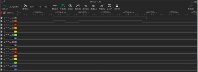

i2c_burst_read(0x0) failed, ret=-5 on ncs v2.4.2
I use nRF52832 device to test I2C reading/writing registers. But it failed with error code -5. What is meaning of error code -5 and how to fix this issue?

00> ledDriverInit
00> tca6424aReadReg(regAddr=0x0)
00> LP5861_REG_ADDR_HIGH(regAddr)=0x0, LP5861_REG_ADDR_LOW(regAddr)=0x0
00> devAddr=0x81, startAddr=0x0
00> [00:00:00.501,129] <err> i2c_nrfx_twim: Error on I2C line occurred for message 0
00> i2c_burst_read(0x0) failed, ret=-5
00> _buttonTimerHandler: 3000
00> now-1-11-30 0:0:0
00> button released
