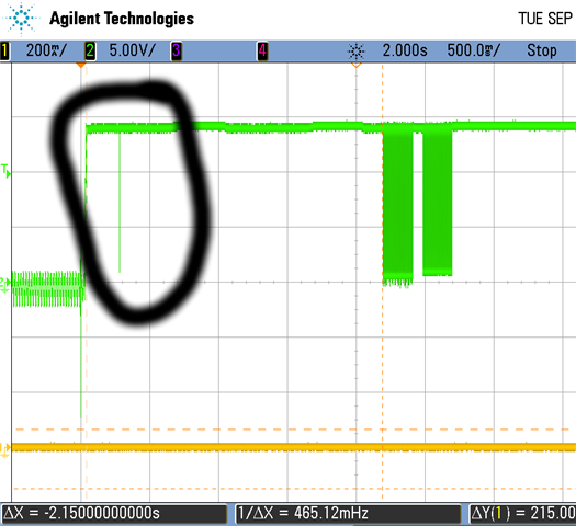

As you can see from the code that, the pin initial state is HIGH. It is also hardware pulled high and we can see that on the scope as well.
Problem Statement:
We observed that the nrf_gpio_reconfigure function, which is called in nrfx_gpiote_output_configure, generates a pulse of around 20microseconds to 50microseconds as shown in the image below.
nrf_gpio_reconfigure function just configures PIN_CNF register for the pin. Why does writing to the register makes the pin to low and change it back to HIGH (which is init val of the pin)?
We observe the same behavior with the product using nrf52840 and also nrf52832.
