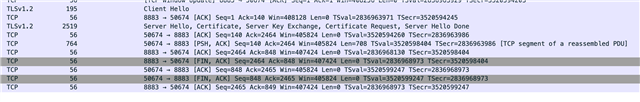

  • Digging more, I've managed to get a Wireshark trace from the other end.
    It looks like the nRF9160 never properly completes the Client Key Exchange step:
    Which NCS version do you use?
    Which modem firmware version do you use?
    Dejan

  • I'll add that I've validated that there is a common cipher suite - both the modem and the server accept at least `ECDHE-RSA-AES256-GCM-SHA384` (if I've understood the modem documentation correctly).
