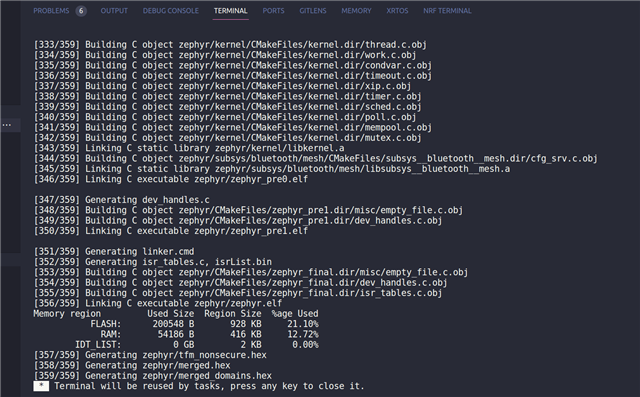

I currently installed the latest version of the NRF connect SDK. I started a new build task which executes properly. The task doesn't however stop.
This is very annoying because I have to restart VSCode for it to stop. Is this a known issue? I can't find a reasonable explenation for it.

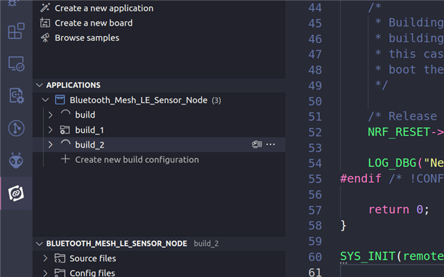

    If there is an error in configuring the network core image in a sysbuild with SDK 3.0.2 VS Code thinks the build never finishes. Is it looking for a file that never comes to determine this instead of the process thread ending since it is reusing the console?
    Edit: Turns out when this happens the build folder is just wrong and it thinks it is a parent-child image. Even after restarting VS Code. By editing the build config and asking it to regenerate it with sysbuild it can work again. (After fixing the config error in the network image.)
