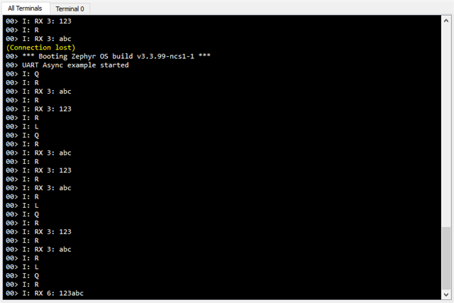

    Reason for resetting the offset is to be able to "prepare" the buffer to receive another message, of varying length. I mean resetting the offset as soon as the contents of the receive buffer has been read is the desired feature.
    The behaviour I noticed in the USART Asynch API is that every single time a new message is being received (and by received, the UART_RX_RDY event is triggered ... and yes, I am aware this event gets triggered for 2 different type of reasons; and maybe here lies the core of the issue, that the same event is triggered for two different types of events), the offset is being increased with the received message length. Eventually the offset+length will equal the receive buffer, but assume there is more data available from the UART comm.
    What is happening for this case is the series of events below:
    1. UART_RX_RDY - current buffer filled up
    2. UART_RX_BUF_RELEASED - as the current buffer has been filled up it is being released
    3. UART_RX_BUF_REQUEST - as there has been a release event a new buffer is being assigned
    4. UART_RX_RDY - the rest of the data is being received in the new buffer
    (code below is based on this example: GitHub - too1/ncs-uart-async-count-rx )

    I chose a buffer size of 8 bytes and messages of length 3 bytes (but the message length is unknown and it can be anything, while 8 bytes for the buffer is to get the behavior to ). I am alternatively sending "abc" or "123". But as I mentioned, the messages can be of any length. As you can see, the last case (which is the worse thing that can happen), when the received amount of data, matches the amount of data available in the buffer, there will be only 3 events:
    ... and once more data is being sent over the UART, there is a UART_RX_RDY event, hence the all data can be read.
    I hope this somehow explains the need:
    • to reset the offset
    • or provide extra information as to what cause the UART_RX_RDY event, such as a TIMEOUT event.
    I had an initial look at the lpuart example. It is closer to what I was having in mind, but the example is basic. IMO it would need a circular buffer to place the received data for further processing. However since I am a newbie when it comes to Zephyr I do lack of the clarity at the moment and request further help.
    Thanks!

    In our case the way we have solved this issue is to:
    1. uart_rx_disable() - disable the receiver - in case of a  UART_RX_RDY event.
    2. folllowed by a uart_rx_enable() - enable the receiver - in the UART_RX_DISABLED event, which is generated following point 1 above.
    Still it is somewhat puzzling why the UART_RX_RDY event is used in so many instances. The presence of a new enumerator could bring further clarity.
