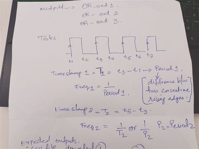

nRF52 Pulse Duration Counter for GPIO - The time between 2 consecutive rising edges
Im trying to measure the time between 2 consecutive rising endges (Rising and Falling Edge together) on GPIO continuously but I did not find any leads. will appreciate the support.

    Say,  what do you mean by 'contiuously'? do those pulses have regular intervals? How long is the interval?
    How accurate does the time have to be?

  • Dear Senchoi, Thanks for the reply. I also read your other threads regarding this. Actually I have 2 requirements for my application,
    1 - I need to measure the 900ns pulse period (consecutive rising to rising/consecutive falling to falling edges).
    2 - The rising or falling edge should be captured from the 1.65V (if the input signal is 3.3V). below 1.65v (either rising or falling should be ignored because of noise signals)
  • Actually I need to measure the time period of the signal (which can start from one rising/falling edge to the next rising/falling edge). in other words i need to measure rising+falling edge and then add both of them. the consecutive means this operation should be carried out untill the last input signal at GPIO present. Actually Im measuring the signal from my other application by using nrf52840 and sending through BLE.

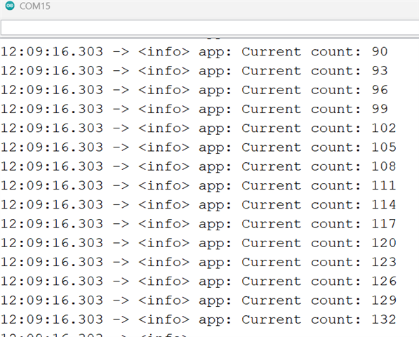

  • Yes, Im trying to use PPI+GPIOTE to capture the signal period. But i cant get the values in nanoseconds as my requirements are 900ns.
  •  after implementing the ppi example I start getting these values. But these values are in ms. How can I increase to nano seconds only the output so that i can capture upto 900 nano seconds
