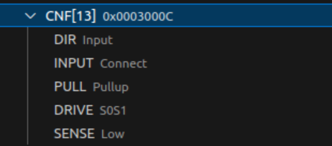

    It seems the issue is that you configure the wakeup button too early so that the configuration register gets overwritten at a later point. You can see this by debugging and setting a breakpoint before going to system off. The CNF registe for P0.13 (button 0), should look like this with sense enabled:
    But when I test your application, it is not. The reason turns out to be that in the implementation of the DK buttons and LEDs library, interrupts are disabled, and with that, sense is also disabled (this happens in the static button_pressed() function in dk_buttons_and_leds.c). So you should enable sense as the last thing you do before entering system off mode, moving the two relevant lines to right before the call to pm_state_force().
    Note that even with this change there is a theoretical chance for getting a button interrupt between enabling sense and entering system off mode, so it could be good to disable interrupt with irq_lock() before enabling sense and entering system off. This way there is no risk of getting the wakeup configuration modified by the button library (or anything else) before entering system OFF.
