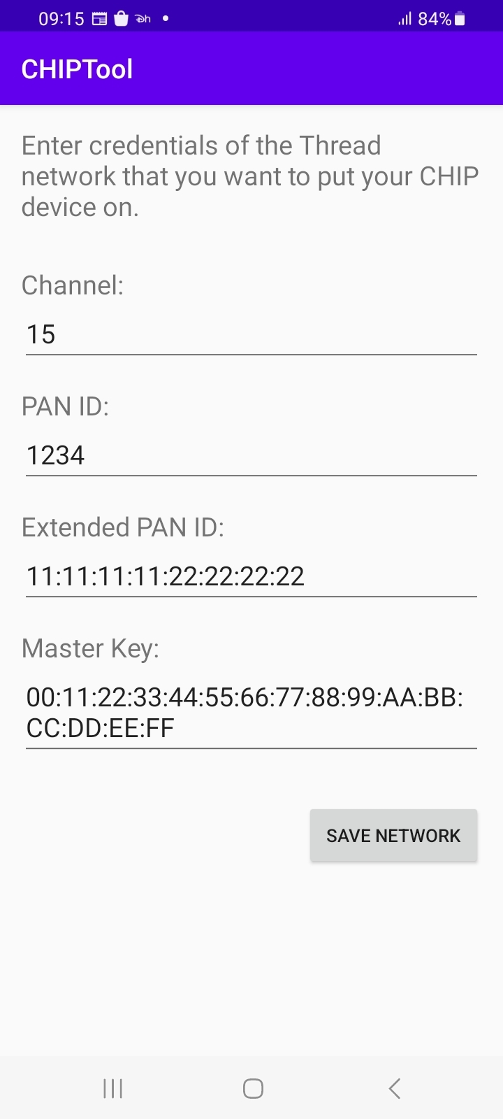

I am adding the screen shot of the that thread credentials page.

Hi Charlie,
I am not following a particular document but i am trying matter light_bulb sample to commission with Android chip-tool and if i scan the QR code after that this page comes and if i submit it without changing anything, then pair is failed immediately.
Hi Rajesh,
chip-tool
instead of Android CHIP Tool. I think that Android CHIP Tool always was buggy in interactive mode. We have removed support for the Android CHIP Tool in our latest NCS version, as we do not have an active maintainer, plus now we have the Google Home or Apple Home apps officially.Best regards,
