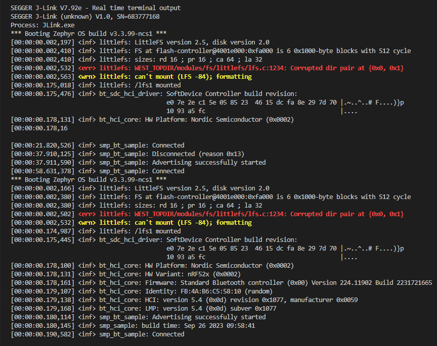

    However, I encountered an error in the RTT log related to LittleFS. Here’s the log for your reference:
    The error message “Corrupted dir pair at {0x0, 0x1}” appeared and it seems that LittleFS couldn’t mount and had to format. I’m wondering if this is something I should be concerned about

  • Glad to hear that you resolved the issue with the guide and a different phone
    AFAIK the warnings and errors highlighted are caused by LFS needs to be initialized, which is usually handled sometime right after restarting the firmware
    In my end the warning and error is gone after restarting the firmware both for the initial firmware running, and the updated firmware after dfu, i.e: Flash, reboot dk and see the warnings disappear, perform dfu -> reboot DK and see warnings disappear
    Does the warnings persists after you reboot the dk after performing DFU?
    Andreas
  • The warnings are gone after the reboot.
    Thanks a lot for your help!
