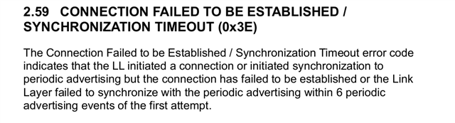

    It sounds like the connection fails to be established. When this happens, you will still receive the connection callback, giving the impression that you are connected. However, the disconnected callback will follow shortly after, with the disconnect reason being '62'. This reason corresponds to BT_HCI_ERR_CONN_FAIL_TO_ESTAB. This error indicates that while the central device was successful in sending the connection request, the peripheral device either did not receive it or did not acknowledge it, which most likely is caused by the interference from the WiFi networks in your case.
    Excerpt from Bluetooth core spec. Vol. 1, Part F
    BT_HCI_ERR_CONN_FAIL_TO_ESTAB is an error you will see from time to time even under normal conditions and is normally fixed by trying to re-connect. After receiving the disconnect event, does your app try to connect again?
