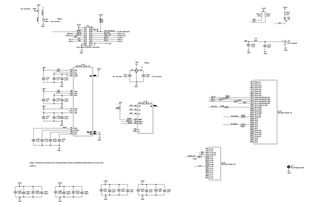

This is my custom board that i believe is working (because it shows up using nrf connect)

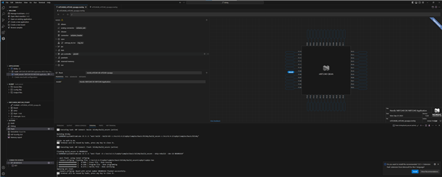

However when i flash the blinky example from the sample projects it does not blink.
The current consumption of the board is odd, 1mA at 3V3 (4mA when programming) this seems normal when looking at other boards.
I am using the build configuration from "nrf5340dk_nrf5340_cpuapp". with a overlay to delete all pin definitions and redifine led0.
Did i make any obvious mistake?

Board schematic. used reference design from datasheet (design 3)
https://infocenter.nordicsemi.com/index.jsp?topic=%2Fps_nrf5340%2Fchapters%2Fref_circuitry.html
my device overlay.
