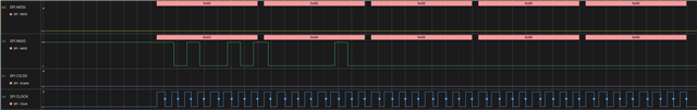

nRf 5340 SPI read only returns a single 0x80 byte in rx buffer
I'm using the arduino_spi device at 1MHz. Writes seem to work fine (the target device is responding as expected) but reads only change the first byte of the rx buffer to 0x80. The LA shows what appears to be correct data coming back from the target. Any ideas? Thanks!
