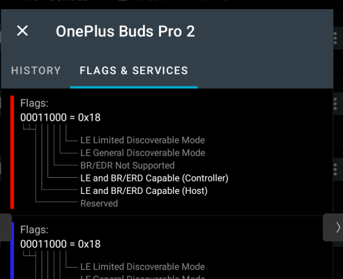

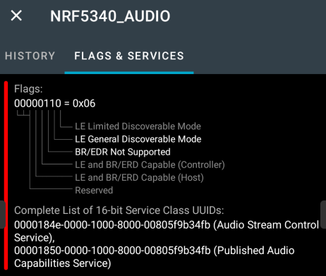

When the dev kits are beaconing, they report that they are 'BR/EDR not supported'.
the earbuds report as follows:
Also, according to the sniffer, the earbuds report that they support LE or dual mode, but are advertising on Legacy.
These are my questions:
- Does the fact that the Earbuds are reporting that they are BR/ERD capable keep them from connecting with the gateway? This should just be a flag saying they CAN support dual mode, not that the server MUST support it, is this correct?
- How come the gateway cannot connect to the earbuds and just negotiate an LE connection and LC3 codec? The earbuds are compatible, and this has been tested using a pixel 7 set to LC3.
- Is this a limitation in the nRF5340 chip or the earbuds?
- Can the gateway even see devices that are advertising on Legacy?
 - If not, I have further questions regarding the life cycle of these chips and how they will interact with existing earbuds.
Any ideas? the goal is simply to get them to connect and listen to music.
    Your understanding of this is correct - the flag is only used to signify to the scanner what the advertiser supports, it does not prevent the central from connecting (unless the device does not support LE Audio, and you have an LE Audio only scanner, for instance).
