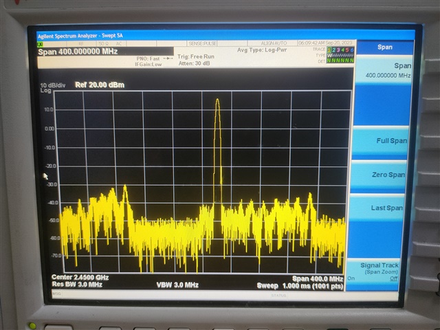

I'am testing nrf52810 and RFX2401 PA, sending ESB packet.
When i testing the radio power use Spectrum Analyzer, it shows that there are noise on other RF channel (see the picture blow).
NRF52810 set to 0dbm.
When i use nrf24l01+RFX2401, there is no that problem.
