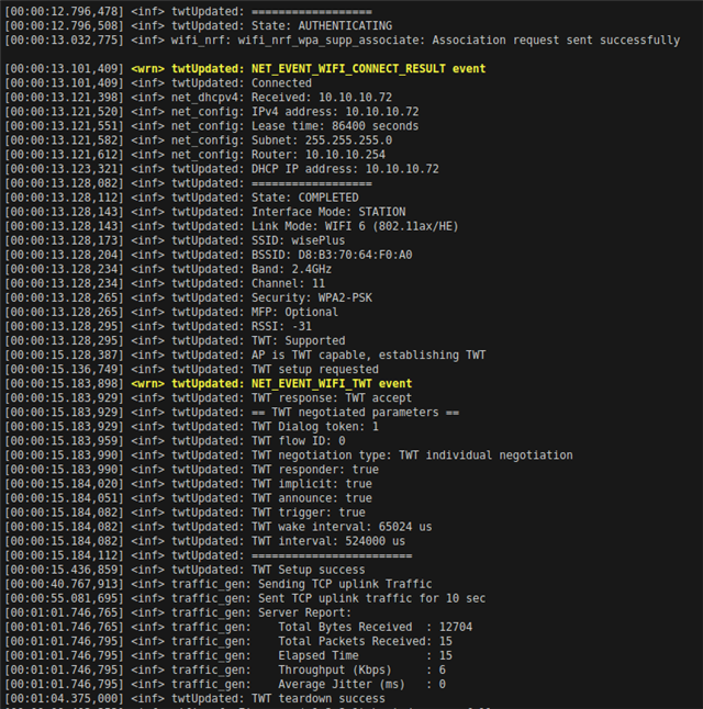

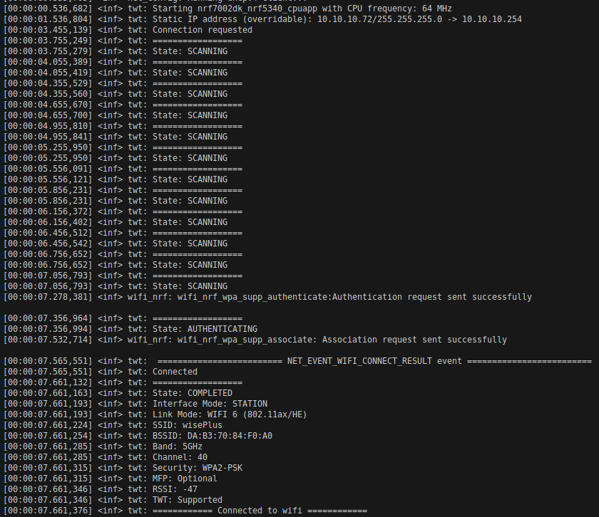

I start by connecting to the AP. To do this, I based myself on the Wi-Fi: Station sample where I get the following output (Image 1) :
  (Image 1 )

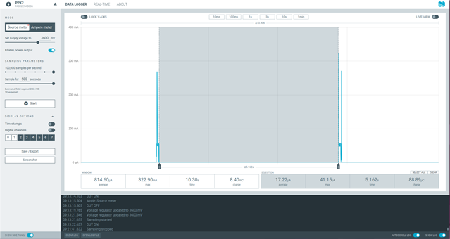

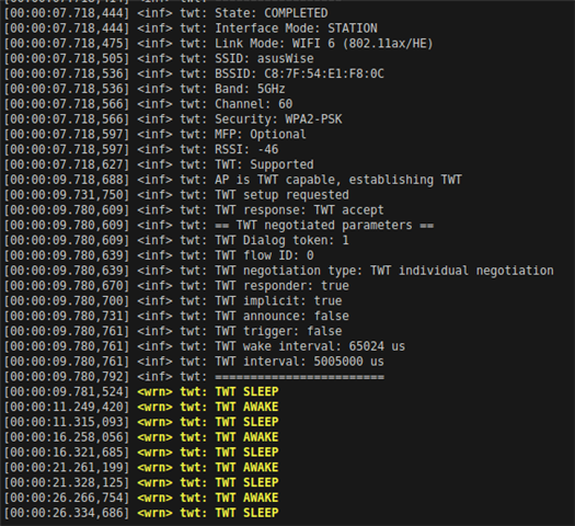

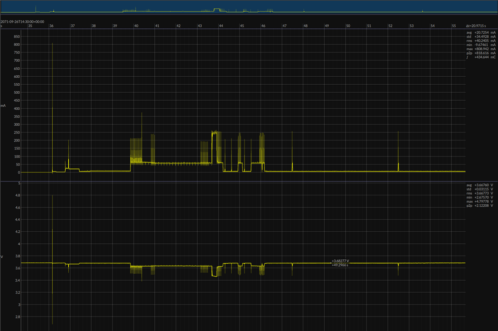

After this, I set up the TWT based on the Wi-Fi: TWT sample with the TWT_WAKE_INTERVAL and TWT_INTERVAL set to 20000us and 5000000us, respectively. I'm obtaining the following output (Image 2):
  ( Image 2 )

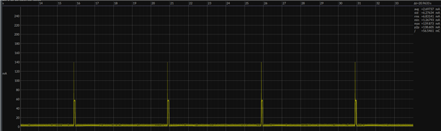

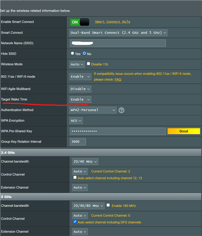

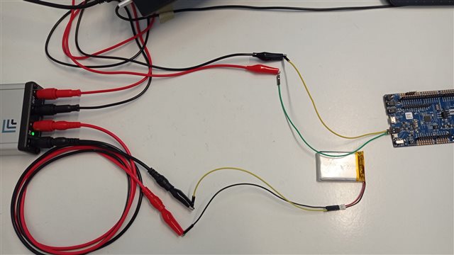

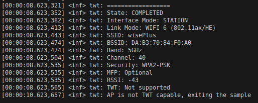

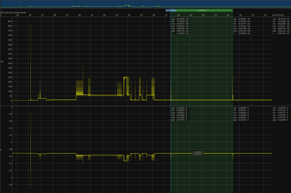

I was expecting that I would get an event when the wake up time and sleep time started. However, from what we can see in Image 2, it appears that I'm not obtaining any NET_EVENT_WIFI_TWT_SLEEP_STATE event. For this reason, I thought that my TWT application was not working (since there were no active or sleeping events), but after a quick test with the Joulescope JS110, I was able to verify that these events were being generated as we can see in the following image (Image 3) and  the TWT_WAKE_INTERVAL and TWT_INTERVAL are correct (Image 4):
  ( Image 3 )
  ( Image 4 )

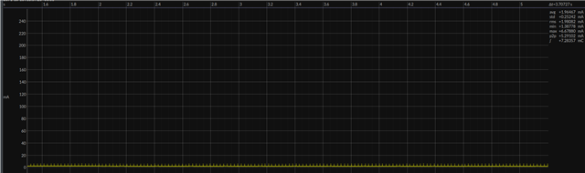

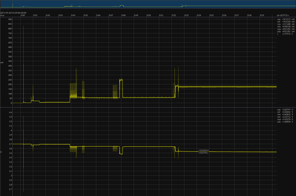

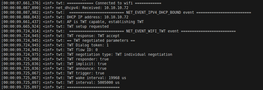

Sometimes looks like the TWT is not set (Image 5):
Thanks a lot!
    What am I doing wrong in the wake up and sleep events detection (in order to send data via UDP during the wake time)?
    I would recommend that you first try with a low TWT_INTERVAL, and then increase this when you have a working setup.
    We are continuously improving our handling in this case. Have you looked at the recently updated twt sample in main? It includes handling for this scenario:
    https://github.com/nrfconnect/sdk-nrf/commit/e05d9c964c8d7a5f77418347deda6f5795cf9b7e
    Q1: Does the firmware run as expected here?
    Q2: Does the current consumption drop after 60 seconds?
    Q3: Which AP are you testing against?
    Håkon
    I decreased the TWT interval to 200ms but the problem remained (I did not detect the wake up and sleep events).
    Regarding your questions:
    • Q1: What is seen in Image 5 does not occur every time. Although the code is always the same, sometimes it presents the result shown in Image 3 and other times it presents the result in Image 5.
    • Q2: When I obtain the result shown in Figure 5, the current consumption always remains around 173mA and never decreases again (even after those 60 seconds).
    • Q3: I'm testing with a Ubiquiti AP. I'm using the UniFi 6+.

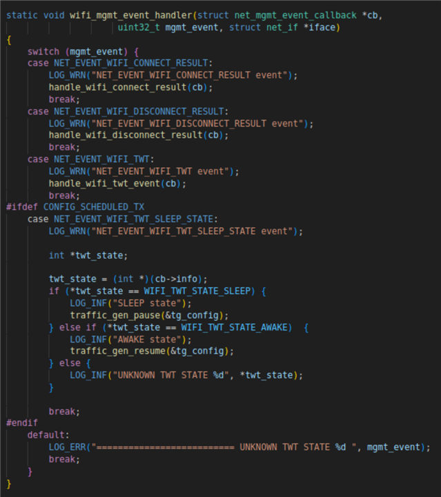

    I was also testing the recently updated twt sample in main and I still can't detect the events. In fact, it seems that it doesn't even enter the NET_EVENT_WIFI_TWT_SLEEP_STATE case.
    In this sample I made the following changes:
    • main.c :
      1. Added the NET_EVENT_WIFI_TWT_SLEEP_STATE to the WIFI_SHELL_MGMT_EVENTS:
      2. Added LOG_WRN to the switch...case to check if these events occurred:

    Yes, as far as I see, you should now have gotten TWT events.
    As your log output shows "wrn", it should be configured with the correct. Are you certain you set CONFIG_SCHEDULED_TX for this build? Could you try removing that ifdef and see if it starts printing? Here's the output when I tried adding the same events and added a LOG_INF print in the event:
    173 mA? That is alot. I have seen RX current levels for 60 seconds if a operation fails (on-air) on previous ncs versions, but this seems like a larger scale problem. If you have an algorithm, or a sample, where this can be seen, I would be very interested in replicating and reporting it internally.
