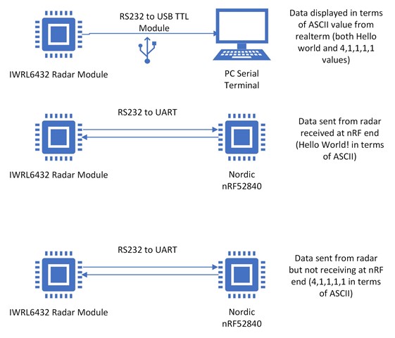

  • Hi Karl,
    Let me explain you in a detailed way. So this IWRL6432 module gives values over RS232 each second which is updated by an internal radar operation(transmission and reception using antennas). Initially, these values were sent in binary format. I was able to read them using a serial terminal but not using nRF52. I did not even want to print the values as I thought there will be data loss as 2 UART are being used simultaneously. My aim was to receive the values, and if a value is received, an LED should be blinking. And in the radar part the parsing was not done by us. TI's internal team did it. THey said that the 4,1,1,1,1 values are sent in terms of ASCII characters. I am able to read hello world from the radar module but not the number values. I hope you have a clarity now. I am also attaching a simple illustration of what the issue is.
    Thank you for the clarification, and for the diagram - this is very helpful for me to see.
    Does this mean that the 4,1,1,1,1 values are sent as the Oct 004 and 001, or does it mean that they are being sent as Oct 064 and 061?
    If the radar always outputs characters (like in the 'hello world' case), then there should be no issue seeing them on the UART, which is why I suspect that the readings might be sent as binary values instead of ASCII characters, leading to an incorrect parsing.
    Do you have access to a logic analyzer? This would let us see exactly what it is that is being sent between the devices, without any uncertainty.
