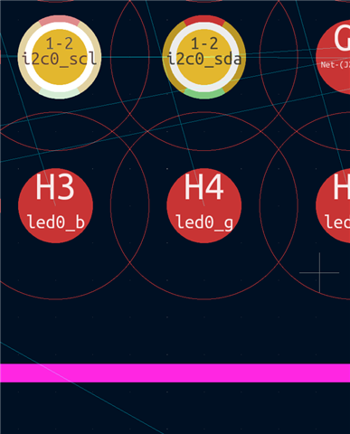

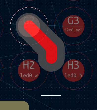

nRF52832 CIAA (WLCSP) BGA Routing Advice?
Hello! I am starting layout with the BGA nRF52832 in KiCAD. I've planned my GPIO usage to avoid the inner IOs, but I do need to access the 2nd row. Given the super tight spacing, how can I route this? I can't on one layer route between the IOs (0.2mm ball-to-ball), but I may be able to place a VIA directly over a ball in the 2nd row and route those signals down to a 2nd layer. Is this the recommended approach?
I'd like to use, for example, PCBWay to create this board, has anyone else routed the CIAA package and had it manufactured by PCBWay or similar online fab?
