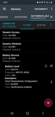

  • Hi!
    You send the value with ble_bas_battery_level_update().
    Take a look at the ble_app_proximity example to see how it done there, the ADC is used there.

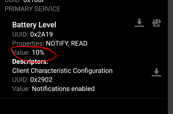

  • Satyabrata Senapati said:
    Actually when I am sending some static battery level value using ble_bas_battery_level_update() ,it is displaying perfectly .But its not working for a counter value lets for testing purpose.means simply it should display the counter value
    1) Could you post some pictures that shows how it display things when it's working , and when it's not working.
    2) And also post some code snippet that shows how you are doing this.
  • ok. Let me send.
    This is the screen shot of nrf_connect app.
    And the code snippet is given below

  • It looks to be working.
    You are sending battery_level = 10
    battery_level = 10;
    err_code = ble_bas_battery_level_update(&m_bas, battery_level, BLE_CONN_HANDLE_ALL);
    and this is also shown in the app
  • Hi sigurd,
    Actually this is working. But my case is if I am sending the counter value its not working. Its not showing the counted value in nrfconnect app.you can see I have commented in the code snippet.
    //battery_level = battery_level + 1;
    // if(battery_level == 8) battery_level = 0;

  • Hi!
    I had a look at the code. What's happening is that the battery level characteristic is set to 11%, and this happens before the phone connects.
    When the central/phone connects, and you enable notification for the battery level characteristic, the ble_bas_battery_level_update() function will only send a notification to the phone if the old value, that is 11%, changes to a new value. Snippet from the ble_bas_battery_level_update() function:
    if (battery_level != p_bas->battery_level_last)
    Since you have hardcoded it to 11%, then no notifications are send. The phone can still read the battery level characteristic "manually" with a GATT read, and receive that the value is 11%. But as long as the battery level does not change, then no notifications are send either.
