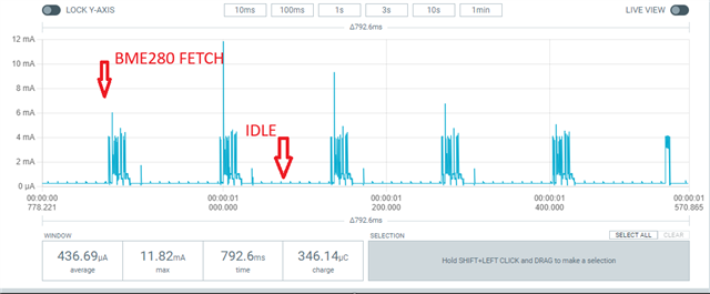

I'm developing an IoT product using nRF52840 provided by Seeed (Xiao BLE) with a BME280 sensor connected via I2C on a custom PCB, without another peripheral that BME280 and passive components for I2C connection. I can't get low power consumption, even if I try the system_off Zephyr example.
When I try the bme_280 example of Zephyr and enable the PM/PM_DEVICE features, the consumption is still so high (about 1mA). I need that it consumes a few hundred uA . An strange ripple between BME280 measurements is seen when I measure current using PPK2:

    I've read PIN_CNF[4] and PIN_CNF[5] registers corresponding to SDA/SCL pins, and there is no change:
    • Before  PM_DEVICE_ACTION_SUSPEND:
    • After PM_DEVICE_ACTION_SUSPEND:
    Also I realize that PIN_CFG[2] bit SENSE is like this (LOW):
    It's that OK? Or maybe it can reset SYSTEM_ON mode?
    In the other hand, I've cutted both (SDA and SCL) traces and current in SYSTEM OFF has made no change.
    If I try sleep_demo of Seeed in Arduino, the power consuption is very low.
    Regards

    Ok, seems my suspicion was right. Can you try to configure the pins back to the default which is as input, input buffer disconnected, no PULL, SOS1, and SENSE disabled? You can write 0x00000002 directly to both registers to put their back to default.

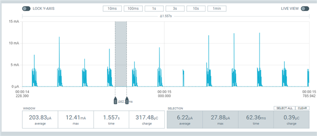

  • Hi Jared,
    I've modified registers with debugger and power consuption has decreased a few dozen of uA. How can I set registers on code? There is some API?
    In the other hand, I realized that SAADC still idle consumes about 200uA. When I measure current with "CONFIG_ADC=n", power consumption turns as desired (just 6uA in idle vs 200uA with CONFIG_ADC=y):

    Very good progress on this,
    I see that there isn't any implementation for the power management module for the ADC yet.
    What API are you using for the ADC, are you using the nrfx driver directly or using the Zephyr API?
