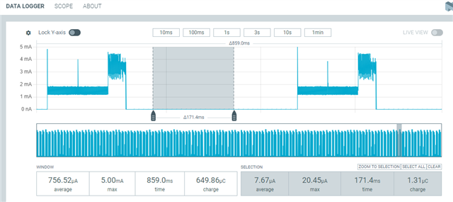

I'm developing an IoT product using nRF52840 provided by Seeed (Xiao BLE) with a BME280 sensor connected via I2C on a custom PCB, without another peripheral that BME280 and passive components for I2C connection. I can't get low power consumption, even if I try the system_off Zephyr example.
When I try the bme_280 example of Zephyr and enable the PM/PM_DEVICE features, the consumption is still so high (about 1mA). I need that it consumes a few hundred uA . An strange ripple between BME280 measurements is seen when I measure current using PPK2:

  • Hi Jared,
    I'm using Zephyr API to measure each 15 min battery level:

    Has nrfx driver power management implementation? Or can I fix it with a workaround in Zephyr?
    Thanks
    No not quite, but you can easily disable the peripheral by calling the un init function. Unfortuantly, the Zephyr API lacks this kind of function which makes it difficult to disable the peripheral.

  • Hi, I'm back with news.
    I could solve it for Seeed Xiao, using SAADC NRFX drivers, and was not necessary to use the uninit() function, provided by SAADC NRFX driver:

    And here is the PPK2 trace, with low power consumption during SAADC standby:
    For some reason, Zephyr RTOS ADC API not manage well power consumption.
