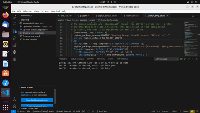

In Ubuntu 22.04 I have a very similar issue.

Thanks for answering. On Mac OS BS I cannot define (using extension nrf desktop in vscode) a location other than opt for deploying blink led. See, I can define /Users/myname/nordic for toolchain and SDK installation, but not for deploying the blink led example app.
In Ubuntu 22.04, I still can't find out where he is trying to create the app so I can show the result of ls -lha here:
OSX: Could you try open vscode as administrator? It sounds like there is some permission error regarding write access to the folder where you want to create your application
Ubuntu: Where do you try to build the application?
