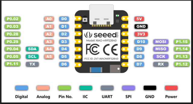

!!!Update!!!
The overlay file is working now. SPI2 needs to be used, with the MISO and SCK pin defined (even though they are unused).
After successfully setting up zephyr and running the blinky example on the Seeed XIAO BLE nRF52840 Sense, I tried to test a connected Adafruit NeoPixel Jewel Ring. Unfortunately nothing seems to be happening, I am pretty sure that I forgot about something or my overlay file is faulty. The LED Ring is connected to the SPI MOSI pin. If someone could guide me in the right direction or give specific advice, I would be very grateful.

&spi2 {
	status = "okay";
	pinctrl-0 = <&spi2_default>;
	pinctrl-1 = <&spi2_sleep>;
	cs-gpios = <&gpio1 15 GPIO_ACTIVE_LOW>; // D10

&pinctrl {
    spi2_default: spi2_default {
		group1 {
			psels = <NRF_PSEL(SPIM_SCK, 1, 13)>,
				<NRF_PSEL(SPIM_MOSI, 1, 15)>,
				<NRF_PSEL(SPIM_MISO, 1, 14)>;
	spi2_sleep: spi2_sleep {
		group1 {

XIAO BLE pinout:
