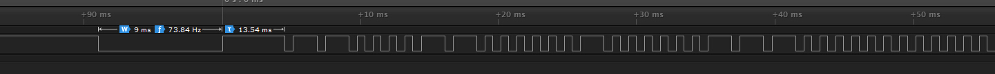

I write an infrared receive driver on example ble_app_uart with softDevice 6, but it not work after I use softDevice 8.How to fix it ? Is there an offical infrared receive driver ? Thank you!

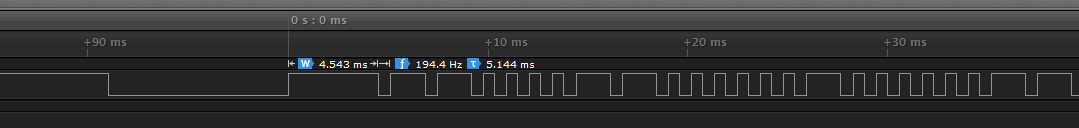

I use HS388D as infrared receiver, below wave is the output by infrared receiver
image description
image description
the first one is 9000us the second is 4543us, so infrared receiver driver store these value to an array 9000 4543 ... ...
