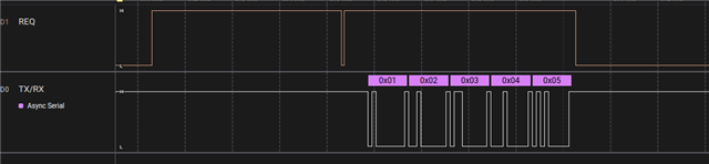

I am trying to get the lpuart sample, interrupt driven, working on an nRF5340DK board. When I run the compiled sample on my DK board I see the interrupt routine is hit only once and no data is sent as observed using a Saleae device. Following the first interrupt hit, the TX line will go low at every iteration through the sample loop but no data and no calls to the interrupt handler. I have also tried this on an nRF52840DK with the same result. Any ideas as to what I might be missing?

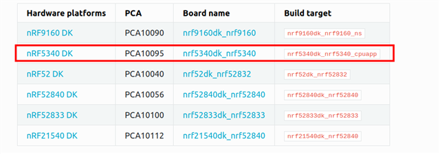

    I was not able to reproduce the issue with the Low Power UART sample when I built it for 'nrf5340dk_nrf5340_cpuapp' which is one of the supported targets:
    Can you please try with nrf5340dk_nrf5340_cpuapp and see if you get the same result? I also tried nrf5340dk_nrf5340_cpuapp_ns, but it didn't work because something is triggering a fault exception in TFM. I haven't had the time to debug it further.

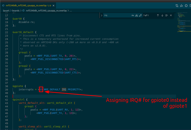

    I was able to reproduce the "unhandled interrupt" error today. I'm not sure why I overlooked it yesterday. The issue for me happened because I had simply copied the 'nrf5340dk_nrf5340_cpuapp.overlay' when creating the overlay for the '5340dk_nrf5340_cpaupp_ns' target and this overlay was hardcoding the IRQ# for the GPIOTE here:

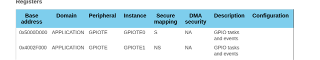

    GPIOTE0 is a secure peripheral and is used when you build for non *_ns targets.
    Fixed overlay:
    0020.nrf5340dk_nrf5340_cpuapp_ns.overlay

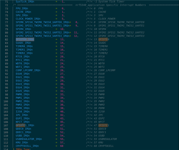

  • Hi Kyle,
    I'm glad to hear that it appears to be working for you as well. The IRQ numbers can be found in the nrf5340_application.h  header located in /modules/hal/nordic/nrfx/mdk/
