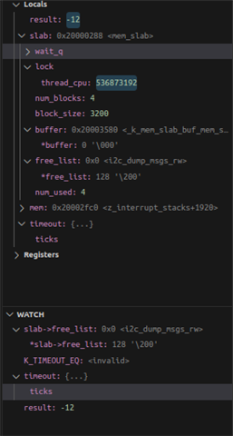

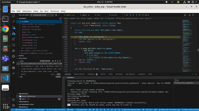

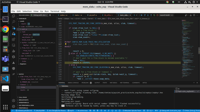

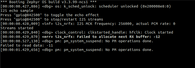

  1. now in ECHO example i got this error :
[00:00:01.960,235] <err> i2s_nrfx: Failed to allocate next RX buffer: -12
Failed to read data: -11
 here is project file :  echo_ESP.zip

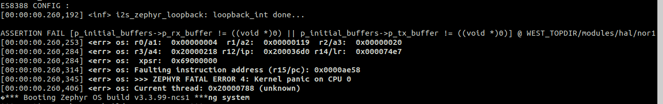

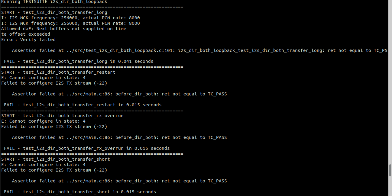

    3.  Now in i2s test api  example : i got this errors:

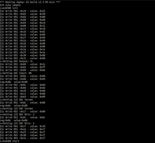

    As per ECHO sample i replace library of WM8731  with ES8388.  i already attached in project file.
    > the I2C address of codec is 0x10 so i replace in overlay file.

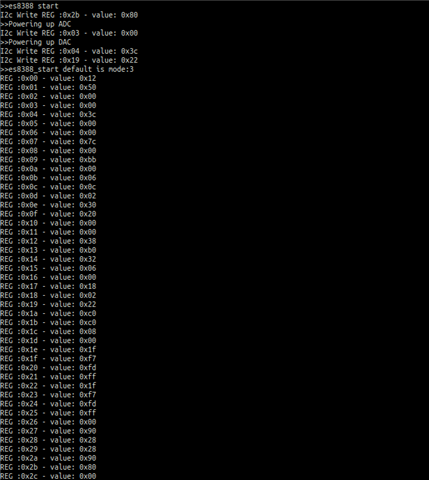

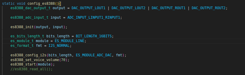

    Here Codec has 4 mode;
    1] only ADC, 2] only DAC, 3] ADC and DAC both , 4] LIN-IN (bypass mode) .
    > The bypass mode is working perfectly. when i set ES8388 as LININ mode.
    >> But in case of I2S  need to set  "DAC and  ADC  both " . now the register of codec is write perfectly as data sheet of code.
    >>  The format  codec is I2S normal.
    >>  data length or sample width is 16 bit .
    >> sample frequency is 8000.
    Now whole code is already i attached above as echo_esp.zip

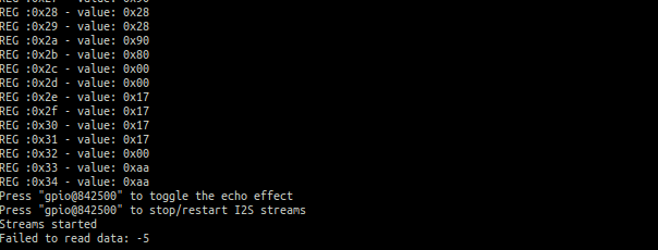

    >> terminal is :
    ERROR : Streams started , Failed to read data: -5

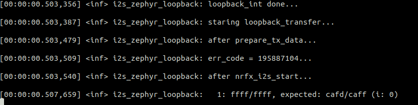

    NOW IN LOOP-BACK  EXAMPLE :
    It is based on nrfx driver , here i am trying  transmitting some data and  receive that data after comparing both and check its same or not: the whole code is below:
    And the physical connection remain same:  also whole project file attached as loopback.zip.

    void loopback_init()
        nrfx_i2s_config_t config = NRFX_I2S_DEFAULT_CONFIG(15, 12, 16, 13, 14);
        // In Master mode the MCK frequency and the MCK/LRCK ratio should be
        // set properly in order to achieve desired audio sample rate (which
        // is equivalent to the LRCK frequency).
        // For the following settings we'll get the LRCK frequency equal to
        // 15873 Hz (the closest one to 16 kHz that is possible to achieve).
        config.sdin_pin  = 14;
        config.sdout_pin = 13;
        config.mck_setup = 0x66666000;
        config.ratio     = NRF_I2S_RATIO_128X;
        config.channels  = NRF_I2S_CHANNELS_STEREO;
        IRQ_DIRECT_CONNECT(I2S0_IRQn, 0,i2s_isr_handler, 0);
        int err_code = nrfx_i2s_init(&config, data_handler);
        LOG_INF("loopback_int done...\n");
    void loopback_transfer()
        LOG_INF("staring loopback_transfer...\n");
        m_blocks_transferred = 0;
        mp_block_to_fill  = NULL;
        mp_block_to_check = NULL;
        prepare_tx_data(m_buffer_tx[0]);
        LOG_INF("after prepare_tx_data...\n");
        nrfx_i2s_buffers_t const initial_buffers = {
            .p_tx_buffer = m_buffer_tx[0],
            .p_rx_buffer = m_buffer_rx[0],
        int err_code = nrfx_i2s_start(&initial_buffers, I2S_DATA_BLOCK_WORDS, 0);
        LOG_INF("err_code = %d...\n", err_code);
        //APP_ERROR_CHECK(err_code);
        LOG_INF("after nrfx_i2s_start...\n");

    static void config_es8388(){
    	es8388_dac_output_t output = DAC_OUTPUT_LOUT1 | DAC_OUTPUT_LOUT2 | DAC_OUTPUT_ROUT1 | DAC_OUTPUT_ROUT2;
    	es8388_adc_input_t input = ADC_INPUT_LINPUT1_RINPUT1;
    	es8388_init(output, input);
    	es_bits_length_t bits_length = BIT_LENGTH_16BITS;
    	es_module_t module = ES_MODULE_ADC_DAC;
    	es_format_t fmt = I2S_NORMAL;
    	es8388_config_i2s(bits_length, ES_MODULE_ADC_DAC, fmt);
    	es8388_set_voice_volume(70);
    	es8388_start(module);
    	//es8388_read_all();
    	printk("ES8388 CONFIG : \n");
    void main()
    	config_es8388();
    	loopback_init();
    	loopback_transfer();
    The  terminal screenshot:
    the board is continuously booting ::
    ERROR:
    ASSERTION FAIL [p_initial_buffers->p_rx_buffer != ((void *)0) || p_initial_buffers->p_tx_buffer != ((void *)0)] @ WEST_TOPDIR/modules/hal/nor1
    [00:00:00.260,253] <err> os: r0/a1: 0x00000004 r1/a2: 0x00000119 r2/a3: 0x00000020
    [00:00:00.260,284] <err> os: r3/a4: 0x20000218 r12/ip: 0x200036d0 r14/lr: 0x000074e7
    [00:00:00.260,284] <err> os: xpsr: 0x69000000
    [00:00:00.260,314] <err> os: Faulting instruction address (r15/pc): 0x0000ae58
    [00:00:00.260,345] <err> os: >>> ZEPHYR FATAL ERROR 4: Kernel panic on CPU 0
    [00:00:00.260,406] <err> os: Current thread: 0x20000788 (unknown)
    This (-5 = -EIO) comes from i2s_nrfx_read() in zephyr/drivers/i2s/i2s_nrfx.c, due to -ENOMSG returned from k_msgq_get(). So this is either a timeout waiting for I2S data, or the internal state is I2S_STATE_ERROR. Can you check with a debugger which is the case?
    It is booting because this assert in the implementation of nrfx_i2s_start() in nrfx_i2s.c is failing:
        NRFX_ASSERT(p_initial_buffers->p_rx_buffer != NULL ||
                    p_initial_buffers->p_tx_buffer != NULL);
    So there is something wrong with the buffers you provide. Looking at your code I see this:
    		void *buffer;
    		uint32_t size;
    		int ret;
    		ret = dmic_read(dmic_dev, 0, &buffer, &size, READ_TIMEOUT);
    		if (ret < 0) {
    			LOG_ERR("%d - read failed: %d", i, ret);
    			return ret;
    You are declaring a pointer (buffer) to nowhere, and using it directly. So the assert is expected, and you need to fix your buffer handling.

  • This (-5 = -EIO) comes from i2s_nrfx_read() in zephyr/drivers/i2s/i2s_nrfx.c, due to -ENOMSG returned from k_msgq_get(). So this is either a timeout waiting for I2S data, or the internal state is I2S_STATE_ERROR. Can you check with a debugger which is the case?
    yes it is due to internal state :
    I2S_STATE_ERROR.
  • I see. Then the next question is why is that? There is a few places in the driver implementation where the state is set to I2S_STATE_ERROR. Which is it? And if you keep backtracking, what do you find out about the origin of the error?
  • After backtracking,
     i got this error : [00:00:00.429,870] <err> i2s_nrfx: Failed to allocate next RX buffer: -12
    and in debugger, its  got from : k_mem_slab_alloc() function.
    static bool get_next_rx_buffer(struct i2s_nrfx_drv_data *drv_data,
    			       nrfx_i2s_buffers_t *buffers)
    	int ret = k_mem_slab_alloc(drv_data->rx.cfg.mem_slab,
    				   (void **)&buffers->p_rx_buffer,
    				   K_NO_WAIT);
    	if (ret < 0) {
    		LOG_ERR("Failed to allocate next RX buffer: %d",
    			ret);
    		return false;
    	return true;
    and in k_mem_alloc() function  its come from :
    else if (K_TIMEOUT_EQ(timeout, K_NO_WAIT) ||
    !IS_ENABLED(CONFIG_MULTITHREADING)) {
    /* don't wait for a free block to become available */
    *mem = NULL;
    result = -ENOMEM; <<
    int k_mem_slab_alloc(struct k_mem_slab *slab, void **mem, k_timeout_t timeout)
    	k_spinlock_key_t key = k_spin_lock(&slab->lock);
    	int result;
    	SYS_PORT_TRACING_OBJ_FUNC_ENTER(k_mem_slab, alloc, slab, timeout);
    	if (slab->free_list != NULL) {
    		/* take a free block */
    		*mem = slab->free_list;
    		slab->free_list = *(char **)(slab->free_list);
    		slab->num_used++;
    #ifdef CONFIG_MEM_SLAB_TRACE_MAX_UTILIZATION
    		slab->max_used = MAX(slab->num_used, slab->max_used);
    		result = 0;
    	} else if (K_TIMEOUT_EQ(timeout, K_NO_WAIT) ||
    		*mem = NULL;
    		result = -ENOMEM;
  • I see. That means that you are out of memory for some reason. Have you tried increasing the size of the slab? In main.c you have K_MEM_SLAB_DEFINE_STATIC, where you pass the block size and number of blocks. Can you increase it and see? Also, make sure you free with k_mem_slab_free() as in the example.
  • I am not trying to increase the block size because the macro blocksize calculates its own size. Even if I manually increase the block size, the same error occurs
  • It is calculated based on input parameters. From your main.c:
    #define BLOCK_SIZE (BYTES_PER_SAMPLE * SAMPLES_PER_BLOCK)
    #define BLOCK_COUNT (INITIAL_BLOCKS + 2)
    K_MEM_SLAB_DEFINE_STATIC(mem_slab, BLOCK_SIZE, BLOCK_COUNT, 4);
    There seems to be an issue related to memory allocation or freeing. So either you need to debug further to understand just from that, or you can combine it with some experimentation like this (increasing the memory slab). I don't have ES8388 so I am not able to test your code so I am not able to be more specific at this point, but please share the results of  your debugging and experiments so that we can consider the new information as you find it.
