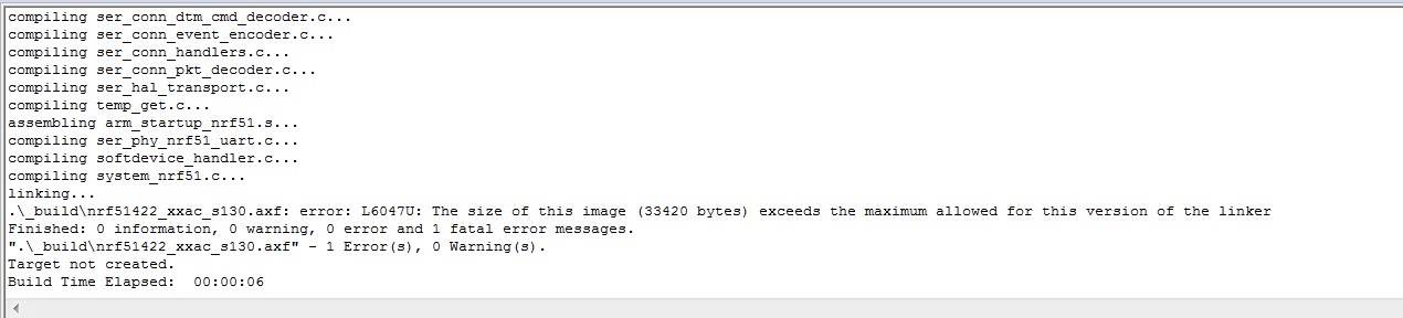

I am working on the ble_connectivity example in nRF51_SDK_8.1.0_b6ed55f. A make error occurs when building this example.
Would you please tell me how can I fix the issue?

The problem is that the free version of Keil has a size restriction of 32k. This image is slightly more than 32 k, so the free version of Keil will not do. You probably have to go with another toolchain, such as GCC or pay for a Kei license.
