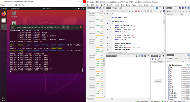

  • I tried Nordic USB CDC ACM sample on another Windows machine and there it is detected fine.
    But on the computer that I have access to it doesn't for some reason. The device is not detected at all.
    1. I looked at BIOS settings to see if devices was disabled
    2. I tested another device (USB stick) on the same port to see if that worked. And yes.
    3. I tried to install nRF utils tools to see if there still was some driver issue.
    4. I tried to power the board through debug USB port to see if power was the issue.
    But it works fine on 3 other machines with different OSes (macOS, OpenBSD and Linux).
    Windows is just too strange. If you could try on Linux it would be great.
    Best regards / Peter

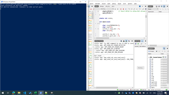

  • I did a test on another Windows machine and there USB is detected fine. The one I am using does not work. But I also noticed that serial ports COM ports are rather written as a number rather than a device name as in Linux.
    Also I cannot detect if device is connected on Windows which was discussed above. So the RW protocol does not work on Windows.
    I made a quick rewrite that possibly could work on Windows. Device is not detected and script is will not be waiting for a command from the nRF device. I will not be able to test this until later this week (I dont have access to this machine) so it may very well have issues.
    usb-test-packed-3-windows.tgz
    So it is certainly much easier to try on regular Linux machine.
  • Hi Peter,
    I see that you updated your reply today with further information on how to run it on Windows. Thank you so much for the help.
    It seems it has an interesting bug where the real port it runs is always 1 number higher than the port given in argument. I.e., below I connect to COM30 by running ruby .\usb-test.rb 29
    Nonetheless, I tried that, and it seems I can produce some issue... The receiving logs showed a lot of data was missing. That probably was not the one you are describing?
    I am not very successful with the Linux virtual machine attempt either. It seems the Ruby script cannot communicate with the device for some reason.
    My Linux colleague can't go to office, unlike I had hoped.
    If push comes to shove, I think I can cook up something on Python to replicate what your Ruby script should do.
    This issue happens when the PC sends a specific length message to the nRF device, right?
    The way I usually attempt to reproduce this kind of issues, I usually setup the TX device to send at a button trigger. In this case, I think I will just setup something simple like when I hit Space, the PC should send "ABCDEFGH00ABCDEFGH01ABCDEFGH02...ABCDEFGH56."
    On the device end, I can try with either your code or a minimally modified CDC ACM example to use the _read_any() API, then slowly add/remove debug logs, depends on the details.
    Do you think a setup like above would work?
    I will also consider asking if someone from another team can give me a hand with the Linux trial.
    Hieu

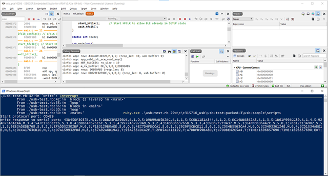

  • Yes, you are correct. Serial port on windows start from 0 which correspond to COM1.
    So to fix that this row could be changed.
    sp = SerialPort.new(serial_dev.to_i - 1, 115200, 8, 1, SerialPort::NONE)
    I looks like at least 2 rows are transmitted in your current windows run. Doesn't go further than that?
    The issue I see on Linux is just at the end of the transmission. And the issue will be seen as wrong (old) data is received from USB internal buffer. If all rows are transmitted correctly the loop should just continue with another transmission from script after 5 seconds.
    If you want to keep the row handling of the firmware i.e. splitting rows delimited by ; maybe you only replace current content examples by to possibly simplify debugging.
    def working_sample
    return "ABC00DEFGHIJKLMNOP;ABC01DEFGHIJKLMNOPQR;ABC02DEFGHIJKLMNOPQR;ABC03DEFGHIJKLMNOPQR;ABC04DEFGHIJKLMNOPQR;ABC05DEFGHIJKLMNOPQR;ABC06DEFGHIJKLMNOP;ABC07DEFGHIJKLMNOPQR;ABC08DEFGHIJKLMNOPQR;ABC09DEFGHIJKLMNOPQR;ABC10DEFGHIJKLMNOPQR;ABC11DEFGHIJKLMNOP;ABC12DEFGHIJKLMNOPQR;ABC13DEFGHIJKLMNOPQR;ABC14DEFGHIJKLMNOPQR;ABC15DEFGHIJKLMNOP;ABC16DEFGHIJKLMNOPQR;ABC17DEFGHIJKLMNOPQR;ABC18DEFGHIJKLMNOPQR;ABC19DEFGHIJKLMNOP;ABC20DEFGHIJKLMNOP;ABC21DEFGHIJKLMNOP;ABC22DEFGHIJKLMNOP;ABC23DEFGHIJKLMNOP;ABC24DEFGHIJKL;ABC26DEFGHIJKL;ABC27DEFGHIJKL;ABC28DEFGHIJKL;ABC29DEFGHIJKL;ABC30DEFGHIJKLM;ABC31DEFGHIJKLM;EOT;"
    end
    def not_working_sample
    return "ABC00DEFGHIJKLMNOP;ABC01DEFGHIJKLMNOPQR;ABC02DEFGHIJKLMNOPQR;ABC03DEFGHIJKLMNOPQR;ABC04DEFGHIJKLMNOPQR;ABC05DEFGHIJKLMNOPQR;ABC06DEFGHIJKLMNOP;ABC07DEFGHIJKLMNOPQR;ABC08DEFGHIJKLMNOPQR;ABC09DEFGHIJKLMNOPQR;ABC10DEFGHIJKLMNOPQR;ABC11DEFGHIJKLMNOP;ABC12DEFGHIJKLMNOPQR;ABC13DEFGHIJKLMNOPQR;ABC14DEFGHIJKLMNOPQR;ABC15DEFGHIJKLMNOP;ABC16DEFGHIJKLMNOPQR;ABC17DEFGHIJKLMNOPQR;ABC18DEFGHIJKLMNOPQR;ABC19DEFGHIJKLMNOP;ABC20DEFGHIJKLMNOP;ABC21DEFGHIJKLMNOP;ABC22DEFGHIJKLMNOP;ABC23DEFGHIJKLMNOP;ABC24DEFGHIJKL;ABC26DEFGHIJKL;ABC27DEFGHIJKL;ABC28DEFGHIJKL;ABC29DEFGHIJKL;ABC30DEFGHIJKLM;EOT;"
    end
    I will also try to reproduce the same issue on Windows later this week.

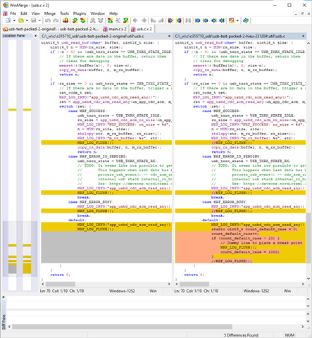

  • Another engineer took a quick look and pointed out that you are having NRF_LOG_FLUSH() in the USB event handler, which would cause delay in interrupt execution, potentially caused timing issues.
    Could you please disable logging entirely and run a test?
  • Ok, yes I tried both to comment out all logging in usb.c i.e. in all eventhandlers and also tried to disable in sdk_config (NRF_LOG_ENABLED = 0), but it seems to behave as before.
    When I run this on Ubuntu 20.04 the "working_sample" continues i.e. transmission completes with multiple transmissions. While "not_working_sample" does not.
    This is the code I used in this test.
    usb-test-packed-4.tgz

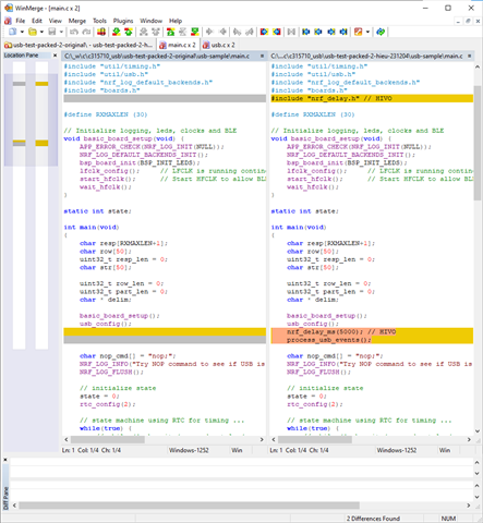

    With Python, I was able to reproduce some problems... The state machine in usb.c resulted in app_usbd_cdc_acm_read_any() being called even when the transmission is over, which leads to an infinite loop where app_usbd_cdc_acm_read_any() would return 8, NRF_ERROR_INVALID_STATE.
    Furthermore, I see that with both the working_sample and not_working_sample...
    This test was run with usb-test-packed-2.tgz with these modifications:
    1. A 5000ms delay after usb_config() in main.c, as discussed in this reply.
    2. usb.c::usb_read_buf() to not flush the log, as suggested by my colleague in this reply.
    3. usb.c::usb_read_buf() to let the debugger stop the execution if app_usbd_cdc_acm_read_any() starts returning 8 too many times.

    // Breakpoint hit
    Modified usb.c::usb_read_buf():
    // The changes a bit higher is also just a commented out NRF_LOG_FLUSH().
    Modified main.c:
    Here is my test setup:
    Device side:
    usb-test-packed-2-hieu-231204.zip
    Host PC side, including logs:
    c315710_python_script.zip
    Once again, my apology for having been unable to help.
    Hieu
