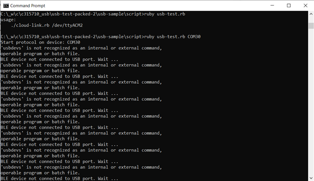

    Regarding ruby it should only be to install ruby and one single gem serialport.
    Make sure it looks something like this.  Later ruby version should also be fine.
    Ah yes. I have Ruby 3.2.2 and serialport gem version 1.3.2. The hiccups I mentioned was embarrassingly with the installation... Turns out I had some misunderstanding about the MSYS2 part of the installation log, and everything went (almost) fine...
    However, when I run the script, it is not working though.
    There were a couple of error message during installation about the wizard being unable to find catgets and libcatgets for removal to avoid conflicts.
    Seems related to this PR. I don't think this is an issue though.
    I will try and see if this is just some simple differences in COM port handling between Windows and Linux and fix it. If that doesn't work, I will figure something else out. I will keep you posted, nonetheless.
