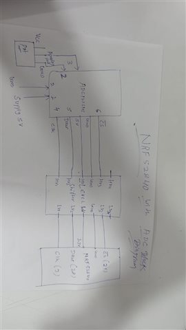

Hi
i am reading ADC121S101CIMF using spi but i not getting correct value at some different voltage .which is mention in below file. and input given by potentiometer ( 5 k ohm ) in analog pin of adc
 1.output file
ADC121S101_with_nrf52840.xlsx
2 block diagram of setup

can you guide why i am getting multiple value and wrong value and same data reading from arduino board i am getting correct value .
