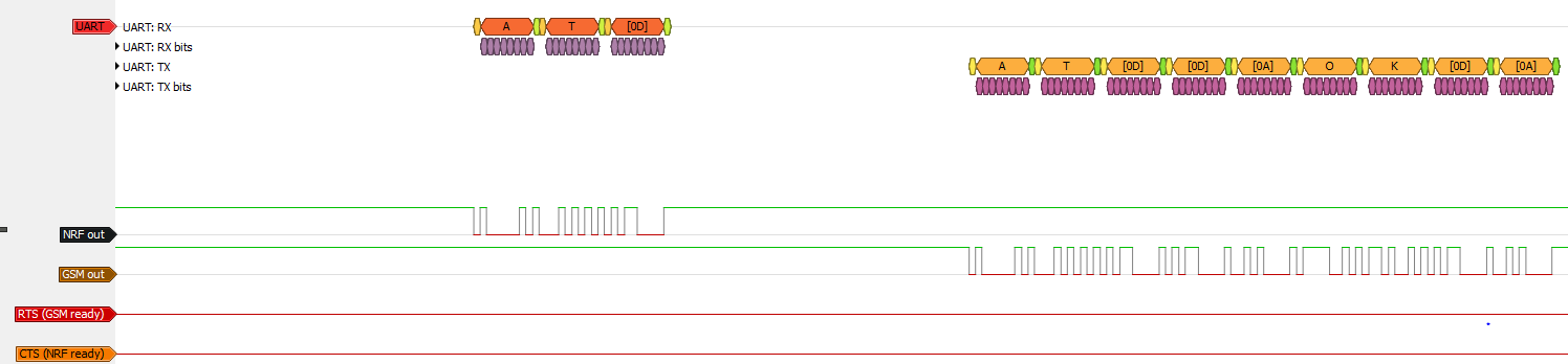

I am communicating with a gsm module and sending at commands to it. So I expect the data to look like this, and it does look like this until i get a frame error. image description

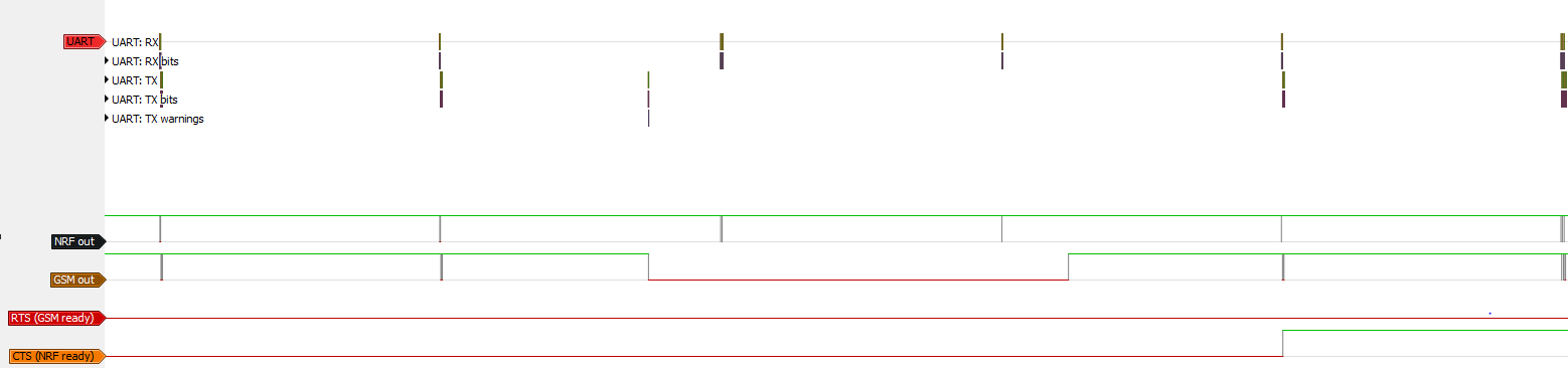

This is a zoomed out image of that command being send every second. After a few seconds the gsm module is reset (when the GSM out goes low). This gives a frame error, and there will no longer be any "data ready events".image description

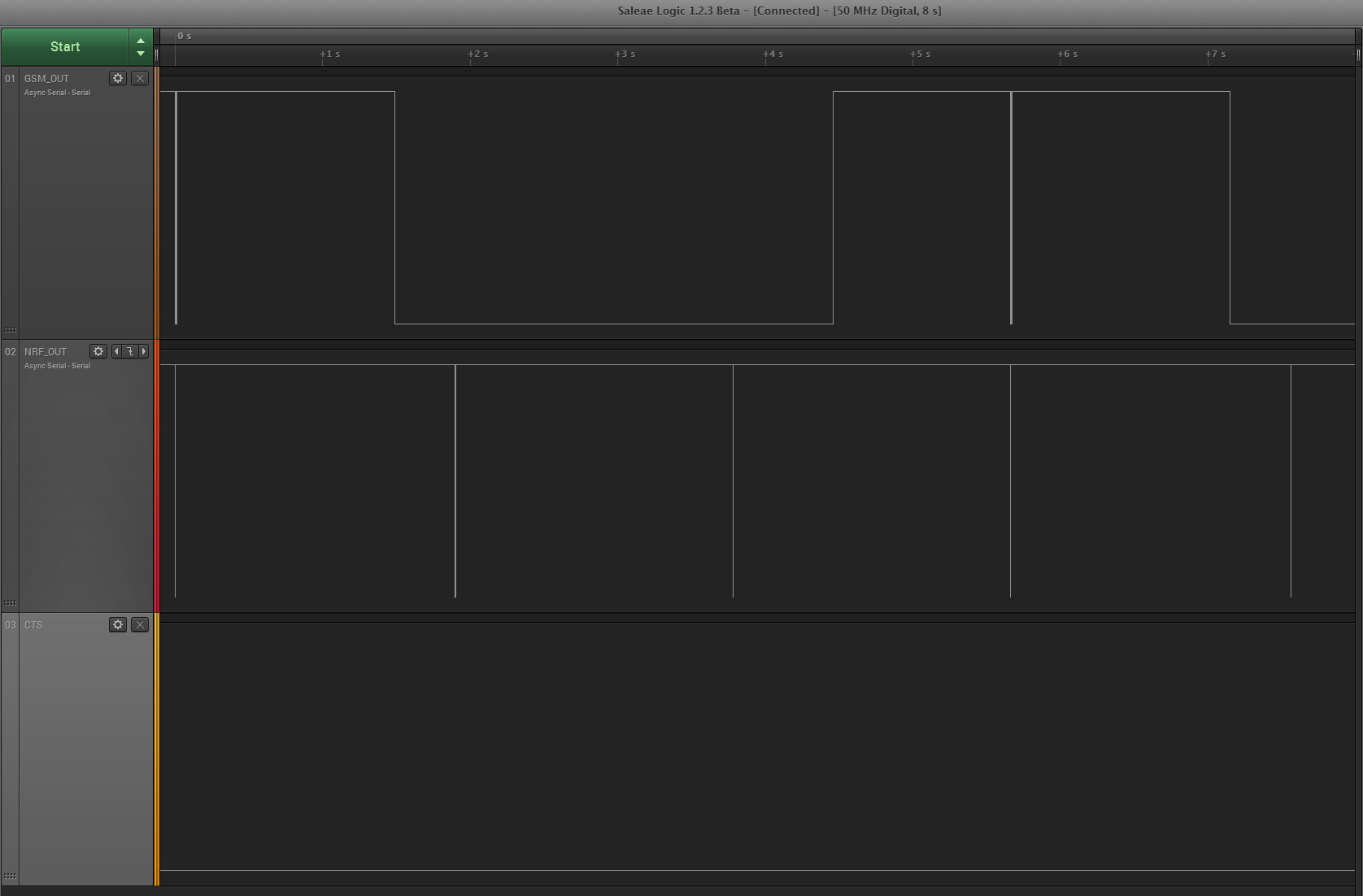

The following picture is after the gsm module has raised its tx pin again. Since the fifo isn't being emptied the cts pin goes high and will never be lowered again. The gsm module will keep sending data in this example though, as i haven't included the command for enabling hw flow control on the gsm command in this code.
