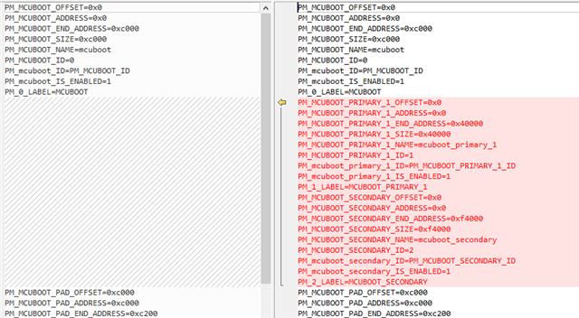

When comparing the pm.config files of our application (left) and the example (right) we see the missing definitions.

    While checking the error logs you shared, I guess this is caused by the setting inside the overlay file. Please take a look at this sample overlay file and make sure you are also setting it like this. I also recommend you share a minimal (with minimum configuration) project, which will help me reproduce the issue here for a better understanding of this issue.

    The error message you pointed out is coming from here. Not sure, but it looks like it lacks some partition that's not defined.
    Could you enable the configuration CONFIG_NRF53_MULTI_IMAGE_UPDATE and give it a try?
