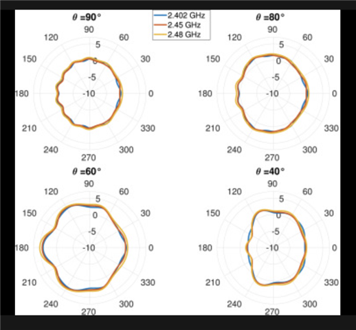

hai team,
My requirement is to design a custom board as a sensor to identify the person who enters and exits the room based on an advertiser device
I had planned to create a custom board with two BLE SOCs, where, if the person (advertiser) crosses the sensor, based on the direction,
if advertisement data is read first on the first soc of the Custom board and next on the second soc on the same custom board which mounted on the wall
then I make an entry as IN
if advertisement data is read first on the second soc of the Custom board and next on the first  soc on the same custom board mounted on the wall
then entry as OUT

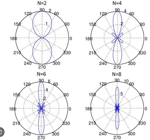

here the problem is  the antenna propagation of signal is 360  like given below
can i customise the nrf52840 soc's antenna like
in case not applicable give me an idea based on my requirement
Note: here direction finding  soc of did not suit, because, at a moment, there are more advertisers will be crossed over the  sensor, connection concept was not suits
only broadcaster and advertiser concepts suit

  • Hello Venkatraaman,
    Sounds like an interesting project!
    I am not sure if I am understanding what you mean here. Though I understand that direction finding might be a bit of an overkill for a situation like this.
    I should mention that there are occupancy sensors etc available out there. Simply using a pair of them might be enough for your use case.
    If you want to pursue this line of thinking I think you might want to try out our distance toolbox. Have a look at this webinar for further details.
