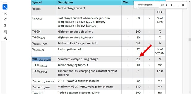

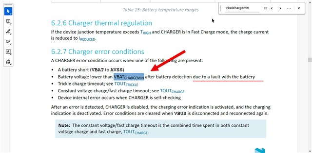

    After thoroughly reading Nodic's nPM1100 Product Specifications document, I think I've found the reason behind the failure.
    Being VBATchargemin 2.1v during charge,
    and "Battery voltage lower than VBATchargemin after battery detection due to a fault with the battery" one of the reasons for the Charge Error Condition, it is obvious that the Charger Block is going to prevent Vbat from charging the battery after an extended time on the shelf.
    Certainly, after let's say six months, of not being used and by natural discharge, any li-ion will get below 2.1v, meaning -if I'm not wrong- that your nPM1100 wouldn't be able to charge it again.
    If this is the case (I hope not), in any Use Case in which the battery should be sealed inside the object to be fed, your PMIC wouldn't be compatible, and this, despite the battery being in perfect condition, as it is in my case, since I can charge the same battery seamlessly, with a conventional CC/CV wired power supply not having this VBATchargemin restriction.

    The charger error mentioned in that sections can be solved by disconnecting and the reconnecting VBUS again.
    ''Could this VBATchargemin restriction be somehow avoided, or the battery fault detector be improved so the flaw mentioned above could be solved?'' In our latest PIMC (nPM1300), VBATCHARGEMIN is not even mentioned.
    I am not entirely sure if this is the only reason for your case. I have asked developer and will come back to you shortly.

    if battery voltage is below 2.1V nPM1100 will not charge it.
    If the product is left unused for a long time, e.g. on the self before a customer buys it, it is recommended to use ship mode to reduce the current consumption (ref section 7.7 in nPM1100 product spec).
    For most batteries they should last a long time in ship mode (460nA), and the battery self discharge is much higher.
