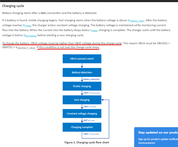

I am testing a 4.2v Li-Ion battery charger mock-up with a Wireless Power Transfer having an nPM1100-EK at the end of the Secondary Stage and using its VOUTB 3v buck output to charge the application circuit. Everything works as expected except for one detail.
If I don't use the device for a long time, let's say one month, and even with no load in the VOUTB output, VBAT goes too low, and when I switch back the system, your nPM1100-EK turns on the red LED, apparently preventing the recharge.
The only way to come around the problem I've found was to remove the battery from the mock-up and charge it directly with an external CC/CV wired power supply till I reach VBAT above 3 volts. Then, if I place the battery back on the wireless charging device, the green LED goes on, seamlessly completing the charging cycle as many times as I need.

    Can you please check the VBUS voltage? If the VBUS voltage goes below VBAT, battery can not be charged.

    Of course, in my circuit, the Vbus>Vbat condition is always met since an LDO precedes your nPM1100 with a 5 volts regulated output, whose input is constantly monitored to be between 4,5 and 45 volts.
    In my opinion, the problem arises when Vbat, due to natural auto-discharge, goes below Vbat <2.30V (which, according to your nPM1100-EK User Guide, is the minimum battery operating input range). Then, apparently, and being the battery in perfect condition, you can`t recharge it anymore using an nPM1100 EK PMIC. The ERR LED goes ON and prevents the battery from charging.

    You are sure that both voltage of VBUS and VBAT did not go below the minimum range?
    Brown Out Reset (BOR) occurs if both supply voltages /VBAT and VBUS)are below the minimum of the parameter range. The device is held in reset, or System OFF, when both supply voltages VBAT and VBUS are below minimum thresholds.

    You can be sure that VBUS input voltage is within the recommended operating conditions, that is, between 4,1v and 6,7v.
    The problem occurs when VBAT is below more or less 1,8v (by natural discharge). Then, if I try to recharge the battery by feeding VBUS with 5v (monitored and OK) from the Wireless Power Supply and using the VOUTB 1,8v output, the red LED goes on, and the operation gets cancelled.
    The funny thing is that if I charge the same battery with a conventional wired Power Supply (5v. CC/CV), the problem does not happen.
