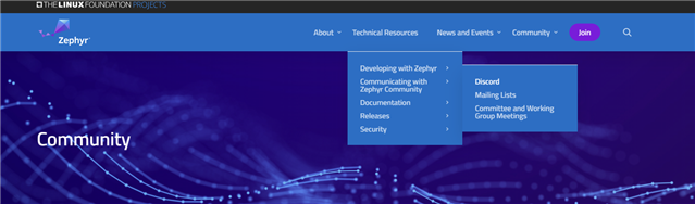

    I also recommend that you use the Zephyr forums which you will find on their Discord channel. Some of the drivers and samples are contributions from the Open source community and you might find people with more experience with those specifics on that forum instead of here on Devzone, but please use Devzone as much as you want. If we believe you will find better help elsewhere on certain topics we will point you where to go
    See https://zephyrproject.org/community/ for a link to their Discord
