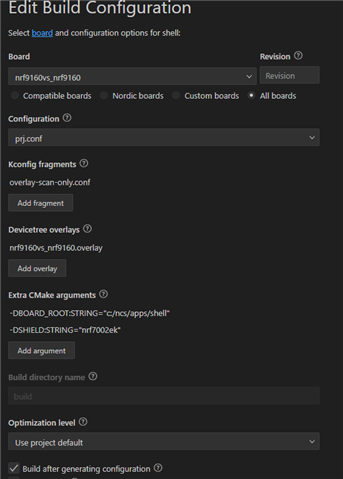

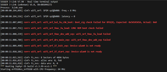

Hi, I am try to scan Wi-Fi networks with my custom board nrf91+nrf7002 (sdk 2.4.1). I am able to build the Wi-Fi shell sample but I get the following error at runtime:

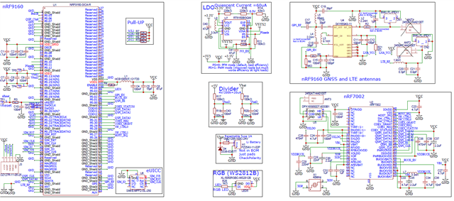

I am not sure I connected everything appropriately as I do not fully understand how the spi connection with nrf91 works and what pin to use in the devicetree.
Any help would be much appreciated.
Current pin config:
Custom board pin  Device tree
31/ QSPI_DATA3 spi3 SCK
0/QSPI_SS iovdd-ctrl-gpios
1/BUCK_EN bucken-gpios
26/HOST_IRQ host-irq-gpios
8  status0-gpios
30/COEX_REQ req-gpios
29/COEX_GRANT grant-gpios
27/SW_CTRL1 swctrl1-gpios
