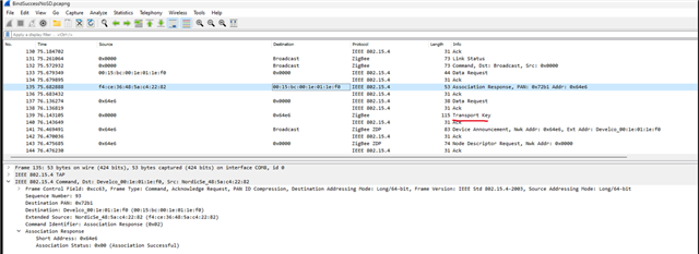

My application is based on nRF5 SDK for Thread and Zigbee v4.1.0.. I have a Nordic Zigbee application that uses libzboss.a and nrf_radio_driver_softdevice.a , with Nordic working as a coordinator. With this application, I was able to bind Zigbee end devices such as motion sensor, window sensor etc and able to receive data from them.

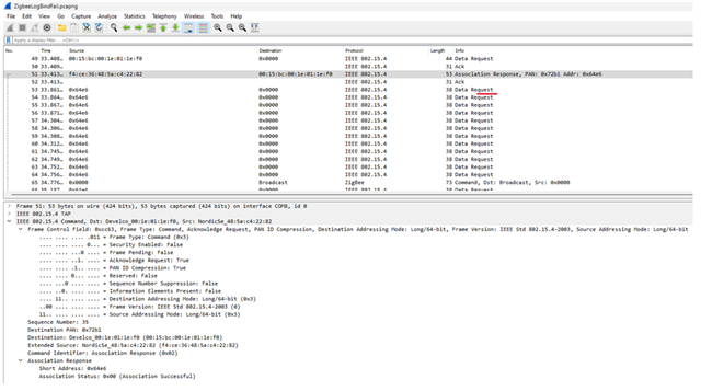

Later, I added softdevice s140 to my application as I wanted my application to be able to operate in either BLE mode or Zigbee mode. After adding softdevice, I had to change the radio driver to nrf_radio_driver_softdevice.a. In this new application, there is no change in code with respect to Zigbee functionality. However, I am no longer able to bind Zigbee end devices.

1. It can boot up as Zigbee coordinator device and can respond to joining request from ZED but cannot bind.

Case 1: Nordic as Zigbee coordinator with only Zigbee support (using libzboss.a and nrf_radio_driver.a) without SoftDevice. I commissioned a ZED (window contact) and the binding was successful. This is the sniffer log. Note: Extended PAN Id of the Zigbee coordinator is F4:CE:36:48:5A:C4:22:82 and the Extended PAN Id of ZED is 00:15:BC:00:1E:01:1E:F0
BindSuccessNoSD.pcapng
Case 2: Nordic as Zigbee coordinator with SoftDevice (using libzboss.a and nrf_radio_driver_softdevice.a). I tried to commission a ZED (window contact) and the binding failed. This is the sniffer log.  Note: Extended PAN Id of the Zigbee coordinator is F4:CE:36:48:5A:C4:22:82 and the Extended PAN Id of ZED is 00:15:BC:00:1E:01:1E:F0
ZigbeeLogBindFail.pcapng
