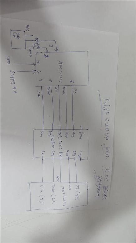

i am reading ADC121S101CIMF using spi but i not getting correct value at some different voltage .which is mention in below file. and input given by potentiometer ( 5 k ohm ) in analog pin of adc
1.output file:
ADC121S101_with_nrf52840 (1).xlsx
2 block diagram of setup:

can you guide why i am getting multiple value and wrong value and same data reading from arduino board i am getting correct value .
I am using SDK Version 15
2211.sdk_config.h
case 1  :  Spi clock line Yellow line output( 5 v )   and  blue line input ( 3 V ) and i am working on 500KHz and i try from                    125Khz to 8M but getting same data
Case 2 : SPI data out line (MISO) same  Yellow line output( 5 v )   and  blue line input ( 3 V )
case 3 :  SPI CS line same  Yellow line output( 5 v )   and  blue line input ( 3 V )
