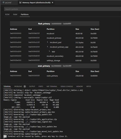

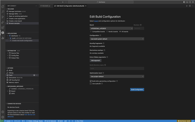

    nrf Connect mesh distributor gives memory overflow when build for nrf52833.  I have uploaded the build configuration I am using. Also attached the build log.
I have tried the solution for memory overflow provided on devzone, increased the
CONFIG_PM_PARTITION_SIZE_MCUBOOT=0xc000 to CONFIG_PM_PARTITION_SIZE_MCUBOOT=0x10000 but still the problem persist.
also tried to increase upto CONFIG_PM_PARTITION_SIZE_MCUBOOT=0x80000, after this the build is successful but flashing to the board causes another error
Log for build with CONFIG_PM_PARTITION_SIZE_MCUBOOT=0x10000

           FLASH:       29758 B       512 KB      5.68%
             RAM:       23808 B       128 KB     18.16%
        IDT_LIST:          0 GB         2 KB      0.00%
[29/50] Linking C executable zephyr/zephyr_pre0.elf
[33/50] Linking C executable zephyr/zephyr_pre1.elf
[38/50] Building C object zephyr/CMakeFiles/zephyr_final.dir/isr_tables.c.obj
[40/50] No install step for 'mcuboot_subimage'
[41/50] Completed 'mcuboot_subimage'
[42/50] Linking C executable zephyr/zephyr.elf
           FLASH:      413540 B 18446744073709547008 B      0.00%
             RAM:      111574 B       128 KB     85.12%
[43/50] Generating zephyr/mcuboot_primary_app.hex
[44/50] Generating zephyr/mcuboot_primary.hex
[45/50] Generating ../../zephyr/app_update.bin
image.py: sign the payload
[46/50] Generating ../../zephyr/dfu_application.zip
[47/50] Generating ../../zephyr/app_signed.hex
[48/50] Generating ../../zephyr/app_test_update.hex
[49/50] Generating ../../zephyr/app_moved_test_update.hex
[50/50] Generating zephyr/merged.hex
Log for flash with CONFIG_PM_PARTITION_SIZE_MCUBOOT=0x80000
 *  Executing task: nRF Connect: Build: distributor/build (active)
Building distributor
/bin/sh -c west build --build-dir /Users/admin/Desktop/Connect_SDK/distributor/build /Users/admin/Desktop/Connect_SDK/distributor
[0/4] Performing build step for 'mcuboot_subimage'
ninja: no work to do.
 *  Executing task: nRF Connect: Flash: distributor/build (active)
Flashing build to 682782848
/bin/sh -c west flash -d /Users/admin/Desktop/Connect_SDK/distributor/build --skip-rebuild --dev-id 682782848
-- west flash: using runner nrfjprog
-- runners.nrfjprog: Flashing file: /Users/admin/Desktop/Connect_SDK/distributor/build/zephyr/merged.hex
[error] [ Worker] - Address 0x00080000 does not map to a known memory.
[error] [ Client] - Encountered error -173: Command erase_file executed for 71 milliseconds with result -173
ERROR: The file specified is not a valid hex file, has data outside valid areas
ERROR: or does not have data in valid areas.
NOTE: For additional output, try running again with logging enabled (--log).
NOTE: Any generated log error messages will be displayed.
FATAL ERROR: command exited with status 52: nrfjprog --program /Users/admin/Desktop/Connect_SDK/distributor/build/zephyr/merged.hex --sectoranduicrerase --verify -f NRF52 --snr 682782848
 *  The terminal process terminated with exit code: 52.
I am new to nrf Connect SDK, kindly guide me how to resolve this issue.
IDE used;- VS Code
Development board used :- nrf52833dk
SDK used :- nrf Connect SDK v2.4.2
