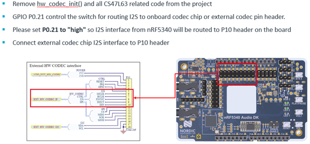

    Could you please give me detailed steps to use external hardware codec?

    Please follow these steps to work with an external hardware codec:
    Karl
  • I made the changes below.
    main.c
    #include <hal/nrf_gpio.h>
    and added
    nrf_gpio_cfg_output(21);
    nrf_gpio_pin_set(21);
    inside
    int main(void){}
    audio_system.c
    "ret = hw_codec_init();"
    delete
    hw_codec.c
    Change all "return ret" in to "retuern 0"
    Are there any other changes?
