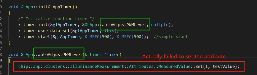

It failed to run attributes set function in the timer callback handler.
Software version: nRF CONNECT SDK v2.4.2.  Project: Matter light bulb
I have created a soft timer, and defined a function named "autoAdjustPWMLevel" as callback handler, like the pic shows.
Everything is fine but when I want to set the attribute value and call this "Set" function, it run wrong even if it compile and build normally.
chip::app::Clusters::IlluminanceMeasurement::Attributes::MeasuredValue::Set()

  • Thank you for your answer!
    I can compile normally. It said "cannot find source file: callback-stub.cpp" in your logs.
    OK, let's forget my project. Maybe I didn't describe my problem very well. There is one thing I want to verify is that can the "Set()" function be used in a timer callback function like the pic shows? It seems not.
    7180.light_bulb.zip
  • The documentation does not specify that you cannot use it. If you are able to start your application in the debugger and step into this function, you can verify yourself if it goes low level in actually calling the protocol stack API to set the attribute. If there is no errors returned, then I do not know why the set function is not working as it should.

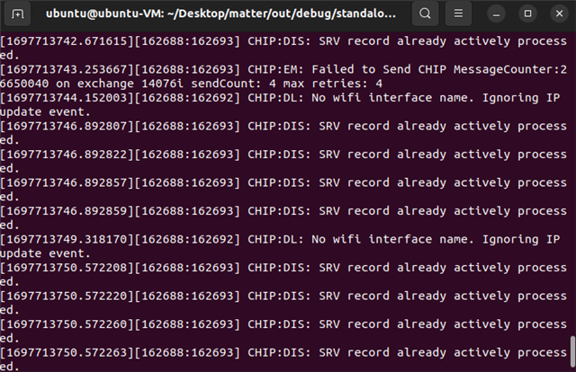

  • Thanks for your help all the time. I have figured out some problems, but therer are still some problems remaining.
    Now the situation is: I put the function chip::app::Clusters::IlluminanceMeasurement::Attributes::MeasuredValue::Set into a timer,which would update illuminance measurement's measured value per second, it seems to run normally. But when if I want to use the command chip-tool illuminancemeasurement read measured-value 2332 1 to read this attribute, its Matter progress seems to collapse totally.And the same problem will occur when I want to "ble-thread" pair the device to OTBR while this "Set Attribute" timer running.
