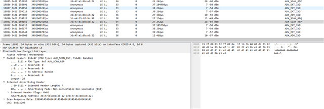

    The scan response packet will contain many 0x41 that make it easy to detect.
    If you see the data on wireshark that means you can get the same data  on your python script, I don't see why you think the firmware on the dongle would be an issue here.

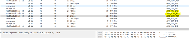

  • Hi Jim,
    Yes, as far as I understand, you are looking for the AUX_SCAN_RSP (scan response) from the DUT.
    For the DUT to send the scan response, you would need to have a scan request (AUX_SCAN_REQ).
    If you take a look at your screenshot or the one I sent you will see:
    It starts with ADV_EXT_IND then AUX_ADV_IND, after that the phone send AUX_SCAN_REQ and then the device under test will send AUX_SCAN_RSP.
    So you need to have a phone that scan and send scan request to be able to capture AUX_SCAN_RSP.
    The problem is that the phone only scan for a short period of time (default 45seconds). You can increase that by going to Menu ->Settings -> Scanner->Scanning Period to increase that.
    After you have that, make sure you have the phone scanning and then try to capture again.

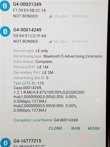

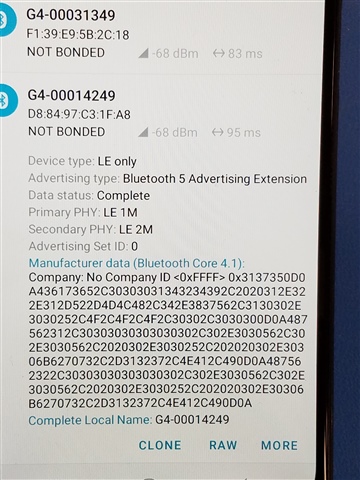

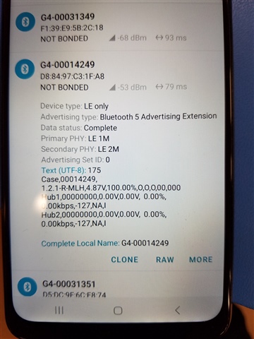

  • Wow, I did not know that. I did what you said and scanned. I took a picture of both the data before the utf-8 decoding and without...
    Do you have Python code (or snippet) that will send this request to the dongle? That is what I may be missing.
    Jim.

  • Sorry but I'm confused. Please be patient I'm trying to understand.
    You say that the dongle doesn't send anything but I thought it has to send AUX_SCAN_REQ. to get the extended advertising data.
    Is the extended advertising data always being sent without a request to send it?
    My setup...
    I have a number of our Bluetooth devices sending out advertised messages.  I have the Android phone scanning using your rfConnect application running on the phone. with a filter of G4.
    The data being captured by the phone is the snapshot of what I sent above. The data seen by the phone is what I like to capture.
    Confused.
    Jim
