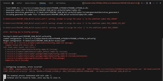

Hi, I have an old project that works with NRF9160-DK, but it uses SDK Connect 1.2.0
Now I have new suite:
Visual Studio Code 1.83.1
Manage Toolchain 2.4.2
Manage SDK 2.4.2
The project fails on build with several error.
Have any suggest to handle my old project?
Thank you
Abele
    nRF Connect SDK v1.2.0 is very outdated at this point. The SDK has changed a lot since this was released, and I wouldn't expect a project built on that SDK to build successfully with a current updated one. Instead, I would just remake the project in the current SDK instead of trying to merge it. That is probably the easiest approach.
